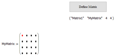

Vladimir sent you the converted file but you may notice that some regions are just converted to pictures, rendering the converted sheet useless. The reason is that the older Mathcad versions were much more powerful than the Prime versions which miss a lot of features. Some of the features not available in Prime like embedding symbolic calculations in a program or the used of scripted components were use by Richard in his sheet and thats the reason its not working in Prime.
In case you are interested here is what it looks like after pressing the "Define Matrix" button
and here is the scipt part of the component:
Option Explicit
Dim State
Text = "Define Matrix"
Sub PushBtnEvent_Start()
  Rem TODO: Add your code here
End Sub
Sub PushBtnEvent_Exec(Inputs,Outputs)
	Dim Regtag, Reg, XML, Val, n, m, i, VarName
	If State = 0 Then Exit Sub
	Regtag = Inputs(0).Value
	For Each Reg in Worksheet.Regions
		If Reg.tag = Regtag Then Exit For
	Next
	If Not IsObject(Reg) Then
		MsgBox "Region tag """ & Regtag & """ not found",_
						vbOKOnly + vbExclamation, "Error"
		Exit Sub
	End If
	If State = 2 Then
		XML = "<ml:define xmlns:ml=""http://schemas.mathsoft.com/math20"">" & vbCrLf & "<ml:id xml:space=""preserve"">MyMatrix</ml:id>" & vbCrLf & "<ml:str xml:space=""preserve"">Matrix not assigned yet</ml:str>" & vbCrLf & "</ml:define>"
   	Reg.MathInterface.XML = XML
		Exit Sub
	End If
	State = 0
	VarName = Inputs(1).Value
	n = Inputs(2).Value
	m = Inputs(3).Value
	XML = XML & vbCrLf & "<ml:id xml:space=""preserve"">" & VarName & "</ml:id>"
	XML = XML & vbCrLf & "<ml:matrix rows=""" & n & """ cols=""" & m & """>"
	For i = 1 to n*m
		XML = XML & vbCrLf & "<ml:placeholder/>"
	Next
	XML = XML & vbCrLf & "</ml:matrix>"
	XML = XML & vbCrLf & "</ml:define>"
End Sub
Sub PushBtnEvent_Stop()
End Sub
Sub PushBtn_Click()
	State = 1
	PushBtn.Recalculate()
End Sub
Sub PushBtn_DblClick()
	State = 2
