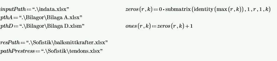

Input data sheet : indata
Mathcad sheet that has my problem statement that needs to be resolved : A Förutsättningar
Mathcad sheet that has one problem already solved (same formula for all points of polygon but variables) : A Förutsättningar_solved
The code is written in this
And further can be found from page 6,7 in both sheets where concrete cross section is mentioned.

For completeness you need to send me balksnittrafter.xlsx to get span information.
Cheers
Terry
Ri,
There must still be something I am missing in terms of files,
Here is the graph on opening the file without calculating. Looks OK
Here is what happens when I press calculate. Pmo is missing. zeros function is missing

Here is the zeroes call
I made it in my toolbox
Pm0 is showing in this calculation sheet
Please see. 🙂
OK have entered zeros and ones function which has got me P.m0.Analys
But under this is the definition of Pm0 derived from Pm0.Analys
I do not have the function in red. RCmatchX( , )
At the top of the spreadsheet I found that *.xlsm is used for the excel file names but I have been supplied *.xlsx files.
You will need to adjust any sheet I send you to match what the excel sheets are named on your system.

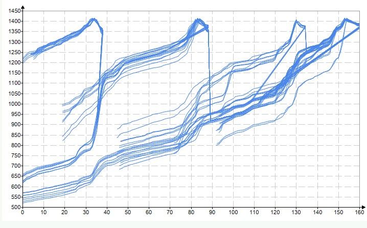

OK sorry for the late reply but have been working on a research project.
Page 49 in draft right hand margin.
Can complete a graph for each individual tendon given its tendon number direct from the read excel data without going through Pm0
Individual tendons is easier to look at results.
It is simple to interpolate this to xber. Will do this later.
Now it is simple to loop the individual tendon method to all tendons.
Same for all tendons but some extra lines in the graph. Not sure if this is errors in the data or plotting errors? I suspect it is in the data.

Have progressed a bit further.
tendon data from the excel prestress table duplicates values
It can be seen in the table below 94.118m data is repeated.
Have written a small program to delete the duplicates
It can be seen the duplicates are eliminated.
This produces a better plot as only single unduplicated points.
Now ready to interpolate at xber.

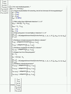

Hey
I have checked and made some adjustments to the original sheet. I am able to work on my problem statement now. I can make varying any property as per 81 variable points from my excel. And interpolate or use my function like multiplespan upto xber=1041 values.
However, I am stuck in this problem in one of my sheets where, although my function is working
to remove non effective parts from polygon. Here I am reading my width paramters like b1,b2,b3, y1,y2,y3 as per i = 1...xber which is 1041 values.
But in this function, I can only do it with one cross section that it reads as yc,zc,ys,zs
Now, if I givesome variable as j=1...LMvar (81 points). It makes 81 (yc,zc) polygon points in a 16*1 matrix (total 81 matrix).
As I can understand, my original function is able to take only 16*1 = 1 matrix and 1 set of points (16) for each yc zc.
It is unable to read a matrix and interpolate as well as unable to use array of matrix in this function even if we resolve to make 1041 values of y and z coordinate matrix interpolated .
So, I want this function to take all cross section points as per xber (1041).. as we move it should interpolate and take the cross section points (16*1) matrix formed for each point.
I.e., first we somehow make interpolated yc,zc points as 1041 matrix of 16*1
And then by someway call and assign each one in this loop so it picks and remove non effective parts from each 1041 points and return me values.
I am unable to figure this out. Can you please help in this? Thankyou

Add these three lines to the program on page 21 to get the section dimensions at each xber
If I adopt this approach. It affects my other things.
For example, this way I called my varying c/s here at top on Page 1
It affects my plotting and hence, results and thus loops ahead.
I have done nothing just used same approach in B1 and also it affects B2 as well as I am changing my yc zc initially itself and not just in that function which should be the correct case.
The function used is just above it in input.
It uses the same excels. Please if you can see.
License for Prime 9 is expiring soon. Will not for various reasons be reinstated till March some time, Thus will not be able to help during this time.
Program at top for yz produces a single column vector of nested arrays hence it has no second column.
