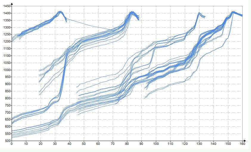

Here is the graph on opening the file without calculating.  Looks OK

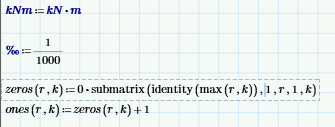

Here is what happens when I press calculate.  Pmo is missing. zeros function is missing
Cheers
Terry
Hey
Here is the zeroes call
I made it in my toolbox
Pm0 is showing in this calculation sheet
Please see. 🙂
OK have entered zeros and ones function which has got me P.m0.Analys

Can complete a graph for each individual tendon given its tendon number direct from the read excel data without going through Pm0
Individual tendons is easier to look at results.
It is simple to interpolate this to xber. Will do this later.
Now it is simple to loop the individual tendon method to all tendons.
Same for all tendons but some extra lines in the graph. Not sure if this is errors in the data or plotting errors?  I suspect it is in the data.

tendon data from the excel prestress table duplicates values
It can be seen in the table below 94.118m data is repeated.
Have written a small program to delete the duplicates
It can be seen the duplicates are eliminated.
Capture3.JPG.
This produces a better plot as only single unduplicated points.
