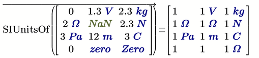

Whenever I think I might be making progress, I hit something that causes me to scratch my head slightly.
This time, it's one of NaN's apparent idiosyncrasies.
SIUnitsOf returns NaN when applied to mixed unit matrices, which is somewhat limiting.
So, having spent a few happy moments programming Yet Another New Version of a function, this time SIUnitsOf, I was reasonably happy with its behaviour.
Then I thought I ought to keep my hand in writing Express-friendly functions and sort of succeeded.
I say "sort of" because I noticed an anomaly: vectorizing SIUnitsOf over a mixed-unit matrix with a pure NaN threw in a spare unit where none was supposed to be.
I've played around with various positions of NaN within the matrix, and it looks as though SIUnitsOf returns the unit of the first element to the NaN under vectorization.
The first question is clearly, "Is this 'anomaly' to be expected?", in which case, what am I not understanding?  If it is unexpected behaviour, is it a bug?
Mathcad Prime 10 worksheet attached.  I've checked in Mathcad Prime Express 7, and the same behaviour is evident.

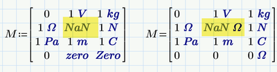

Its not an anomaly of SIUnitsOf and it has nothing to do with vectorization.
Whenever a matrix is created, the 'appropriate' units seem to be added automatically!!
So as soon as you type in the matrix element, the NaN is not a simple NaN but Prime would automatically have added a unit 😞
In case of NaN this can be avoided. If you really want to store a simple NaN without any (automatically added) unit in a mixed units matrix, you have to make it a calculation with result NaN. The picture shows that 1*NaN works. 1+NaN would work as well as would NaN^2.
NaN + NaN does not work and also NaN^0  doesn't have the desired effect. Actually in NaN^n the only value which works OK is n=2 ! Strange!
So your example I could only fix by using 1*NaN instead of just NaN

I suspect, in the light of that additional information, Sherlock Holmes would declare the hand of Professor Bugiarty to be behind the Case of the Added Unit.
Multiplying the NaN by 1 only works if you know ahead of time that you will have a NaN of dimension one in a mixed-unit (OK, mixed SI+money base dimension) array.  Once it's defined, you're snookered.  Even non-clever programming doesn't help because the NaN has already acquired mixed base dimensionhood.
I'm now puzzled as to where the function sin picked up its base dimensionality ... ah, looks like the evaluation of the result, whereas the NaN picks up the unit during assignment.
