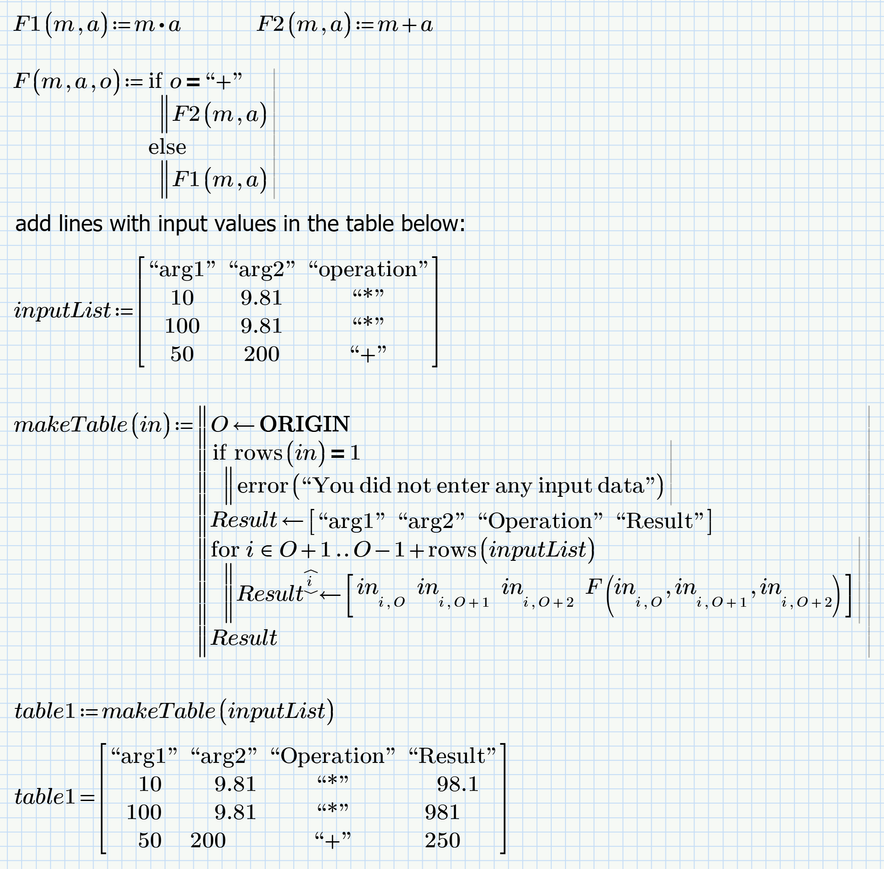

(To:Werner_E)
Here is on possible approach for my option1, turning the calcs into functions. I followed the example you posted but can't be sure if this approach will fit if the calculations are more complex and forked.
The functions (F1, F2) may have different number of arguments. Prime does not allow a user function which can be called with a varying number of arguments. Way out could be to provide all arguments in a vector and just use the necessary one.
The input data also must not be provided in an matrix, but it makes the automatic creation of the table much easier.
Drawback of this method sure is that arguments and operation which should be done cannot be made selectable via ListBoxes but must be typed in manually by the user which is failure prone.
Prime 11 sheet attached

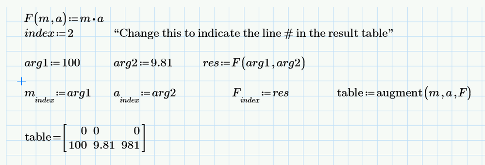

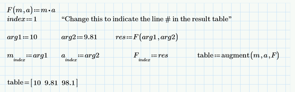

Hello again @terryhendicott
Tried to implement a "semi manual" table appending as mentioned earlier.
This is how it looks when I direct the results to the first line in the table (ORIGIN=1 in this document)
And this is how it looks like when I assign it to the second row.
As you can see, the approach fails because the arrays are re-initialized and the previous table values overwritten by 0. ☹️
Regards
Hallvard

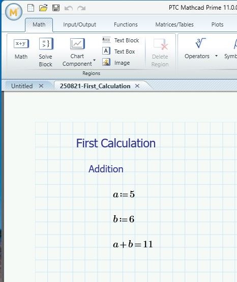

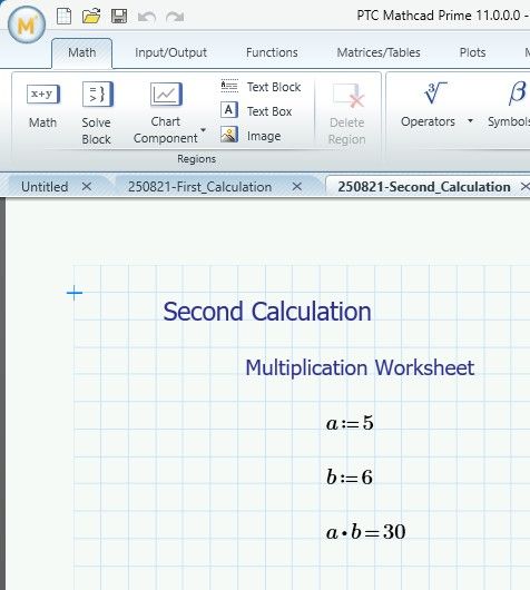

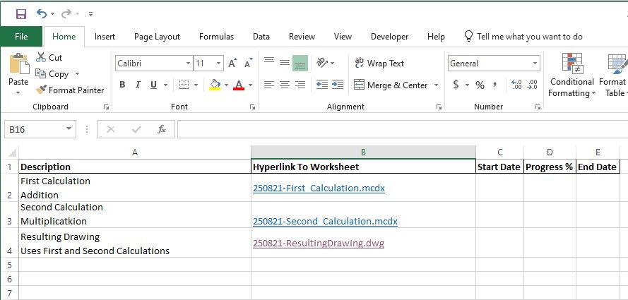

Hi Hallvard,
Know the question has been answered but would like to let you know how to handle the selection of one calculation from 19 possible combinations with the minimum of fuss..
First I would set up an Excel Spreadsheet that controls management and reporting of production of the worksheets.
Then I would create 19 separate Prime worksheets one for each calculation to simplify input and file saving of actual calculations in a specific project.
I would then set  up hyperlinks in the spreadsheet to the files concerned,
Now all a user needs to do is open the Excel spreadsheet.  Click on the hyperlinks. Answer a few security questions about use of hyperlinks in Excel and the file opens up ready for calculation and saving to actually record the inputs and outputs for the specific project.
Cheers
Terry

(To:HP_1364456)
Its still not absolutely clear to me what exactly you try to achieve even though in the meantime you outlined your worksheet structure, but it gets clearer.
Once you change input values at the top of the sheet, the sheet is recalculated from anew and values which were calculated before are lost.
I can see two options to overcome this:
1) turn your calculation into functions of the input values. Then you can call these function(s) one after the other using varying inputs and collect all results in a suitable data structure like an array or nested matrices.
2) Save the results of one calculation run in an external file using an appropriate WRITExxx  function.
To collect a series of runs and avoid to overwrite the data already saved you could either
a) use automatically created different file names for each run, so you end up if one file for each run
b) Use the appropriate READxxx function to read in the data already saved, combine it with the new data and resave
c) If possible an appropriate you also can use WRITEPRN the first time and then APPENDPRN to add data to an already existing file
Which function for writing data is most appropriate depends on the type and structure of your data. See here what Prime has to offer.

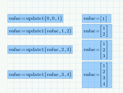

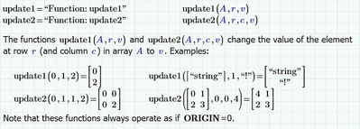

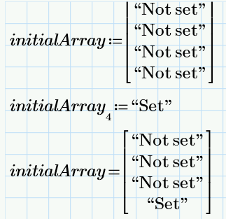

Maybe these two undocumented functions may be of help:
Thank you @LucMeekes
This looks promising. It looks like it is even possible to use it to append to an array.
Value gets more and more elementsValue gets more and more elements
Thank you again, I have to experiment to see how it works together with my combo-box.
Wonder why it is undocumented, can it suddenly disappear in a future release?
Regards
Hallvard
(To:Werner_E)
Hello again @Werner_E
In principle this document looks very much like the structure of my document (BTW, what is the proper name of a MathCAD (Prime) document?)
The difference being the "inputList" definition where I have a "Basic Combo box". This allows me to select several input parameters in one go, without editing the document (just the selection in the "Basic Combo box"). But it only allows one selection at a time, and I want the document to contain a table summarizing several different "load cases".
But I am quite sure your solution will work, the issues I have with this:
  • The user has to manually set up the "inputList" rather than selecting it from a "Basic Combo box",
    This increases the possibility of user error.
  • The user needs to know in advance which load cases and input values to use
Anyway I will use the suggested approach.
Regards
Hallvard
(To:HP_1364456)
Not necessarily. If a user wants to add a load case, instead of creating a new inputList (s)he just adds a line in the existing one.
Of course the whole sheet would be calculated from anew and the load cases which were already calculated are calculated again. I see that this could be annoying if the calculations are very time consuming. In this case the approach of using an external file may be more appropriate.
Problems to solve with this approach are
.) you don't know the directory structure of the user and so probably you must have the user to manually type in a path string (not sure if Primes scriptable components are capable enough to make a file path selectable via a file selection window).
.) You have to indicate in some way that the game starts. The fist time you have to use WRITEPRN, otherwise APPENDPRN
.) When the user finished the calculations, the file would still remain sitting on his storage media and should be deleted. Not sure if a scripted component could be used to do this from within the Prime sheet. Otherwise you would have to instruct the user to clean up manually.
And because you mentioned in a reply that you are considering predefining a larger matrix (which does not work because values that have already been entered do not survive a recalculation): If you can specify a maximum number of load cases, you could copy the input section with the combo boxes several times. They should have a default value of something like “none” or NaN for at least one of them so you later decide if its a valid load case which should be calculated or just a dummy. The user then selects one set of load cases after another. The individual input sections could be arranged in collapsed areas that the user opens as needed for input.
After all input sections, your program can then calculate all relevant valid load cases and display them in a table.
Of course, this approach means that after entering the second load case, the first one is calculated again, and so on.

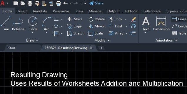

Hi Hallvard,
In version 12 of Prime to be released, one of the predicted new features, will be I hope, page numbering starting at other than one.
I hope someone from PTC is watching this.
This means you can chain print each of the say 19 Worksheets with running page numbers as part of a final report.
The report production can also be included in the overall control Excel spreadsheet.
In the oil and gas industry at the start of each stage of project generation a complete list of predicted deliverables is made by senior staff in advance of any work on the deliverables.  This way production of the deliverables can be managed.  The list is never complete or static as changes can be made during the project stage.  This is subject to a formal change management process.  Part of which is to amend the list of deliverables as necessary to keep the design under control and on track. Many hundreds of deliverables are handled by each of the many disciplines.
I recommend the Excel method.  There are software packages that automate the deliverable creation and all the inter-discipline checking needed of them.
Cheers
Terry
