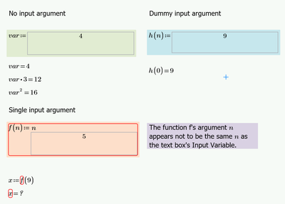

In your sheet you write that opening the protected area is considered cheating. You should also add that evaluating variables First is cheating too 😉
The advanced controls sure need an option to get protected from viewing their inputs and editing.
At the time being the only solution I could think of is the usage of an evaluating function placed in the protected area. But unfortunately it would have to be called in a separate region (maybe a second collapsed area) after the user input was done as it could not be called from within a scripted  control.
EDIT: But it may be possible to use the function call as input of a scripted control. That way we would not have to use an extra region. Haven't tried but I guess this should work.

So you won't know the variables used unless you click on the controls and then look at their input variables, and by that point you should intuitively know you're a cheater.
Because Prime doesn't have area labels (hopefully it will one day), I thought that I'd put a note on what this protected area was so people don't think it's part of the game that they need to look into it.
