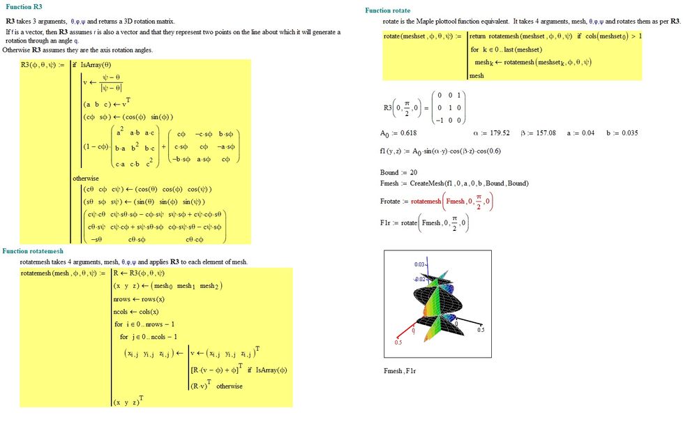

Hello everyone,
I'm trying to use the "rotate" function obtained from the "plottool" collection downloaded from this community some time ago. I would like to know why the "rotatemesh" function is marked in red as it is evident from the following figure, while the function "rotate" which utilizes it, doesn't give error?:

Arrgggh!  Ignore the above.  That's not what's happening.

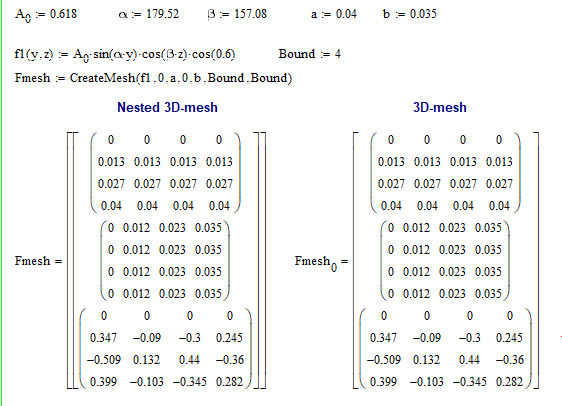

A 3D-mesh is a 3x{mxn} nested array.  rotatemesh is designed to rotate a 3D-mesh.
Createmesh returns a nested 3D-mesh. In your instance, Createmesh returns a 1x1 array containing a 3D-mesh.   To handle nested 3D-meshes, you should use rotate, which is designed to rotate a set of 3D-meshes.   rotate will also handle a 3D-mesh and should, therefore, be used in preference to rotatemesh.
The reason vectorize works on rotatemesh(Fmesh, ...) is because the sole element of Fmesh is a 3D-mesh.   If you'd written rotatemesh(Fmesh,...) that would have worked as well.

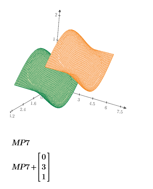

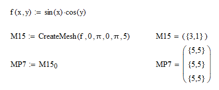

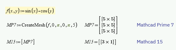

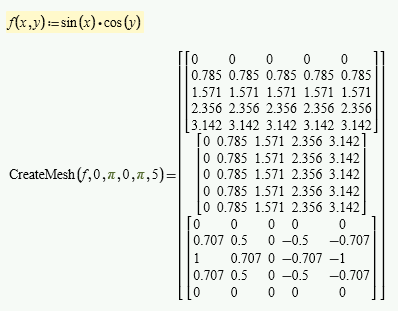

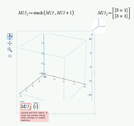

Note that, for some reason or other(*), this is not the case in Prime.
CreateMesh now returns a 3D-mesh and the 3D Plot component no longer accepts a nested array of meshes.  This messed up a lot of my worksheets.

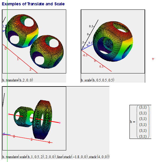

StuartBruff
(To:ttokoro)

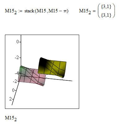

Yes, but, unfortunately, Prime's no longer capable of treating a set of related meshes as one object ... and I don't feel enamoured of the idea of typing in each and every one of the meshes to display several such objects.
I can't do the below in Prime.  I have to scale & translate outside of the plot then manually input each mesh into the 3D Plot.  Or, at least, AFAIA.

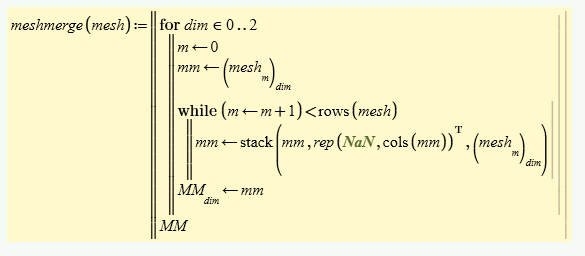

Unless, ... just a minute ...
Doesn't solve all the problems, but ...
where
Stuart

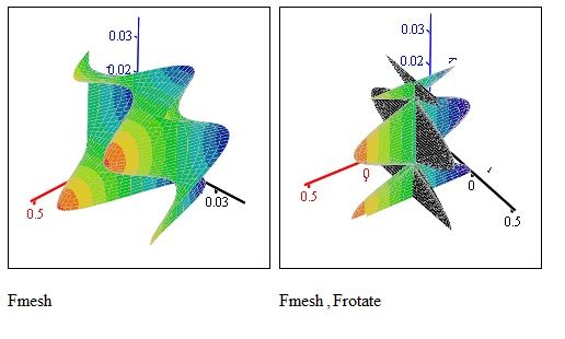

-MFra-
(To:StuartBruff)
The graphics are not clear, that is: since Fmesh represents a surface, applying a rotation to Fmesh should produce the same surface but rotated. Instead rotatemesh produces two sections rotated at ninety degrees, why? it seems wrong to me.
