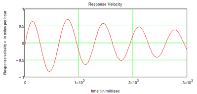

Good Afternoon Mathcad Community,
Attached is a modified copy of FM Wilson-Theta  Mathcad file with units. The displacement ploted correctly but the velocity and the acceleration did not plot correctly. Would anybody be kind to take a look at the file an tell me what I'm missing in the code.
Best Regards,
Boyer
Maybe you confused yourself with variable names 😉
Plot "vel" or "vel_2" over time, not "v" !
BTW, the way you did it you call your functions three times which is quite inefficient.
Its better to do it as follows:
Concerning the plots I would suggest that you divide the variables in the plot by the appropriate unit. That way you are not limited to Mathcads standard units but may show miles per hour over milliseconds or whatever you like:
Furthermore, as you use labels for the axis, you may consider to hide the arguments for a cleaner display.
