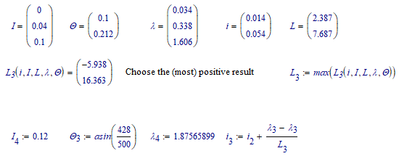

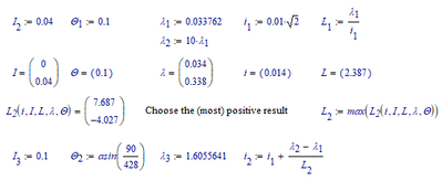

You can solve the equations fully symbolically and then fill in the numbers so as to not loose precision. It starts with:
The above should result in a large expression, and gives two solutions, apparently you want the (most) positive result.
Then you can fill in the numbers and calculate the result and the data for the next iteration:
Then solve the following:
and calculate the result:
etc.
