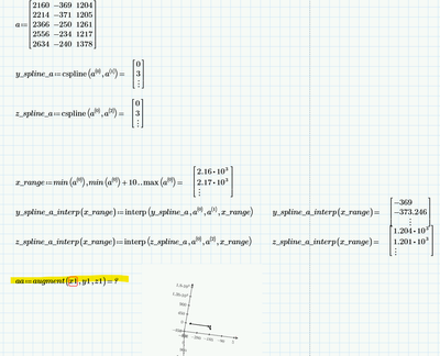

Hello, I'm trying to draw 3D spline go through 5 points defined by matrix "a" .
After defining matrix of x range, y and z, these three matrixes are not able to be combined by "augment" function.
Are there any way to combine these three xyz matrixes? or any other way to plot xyz?

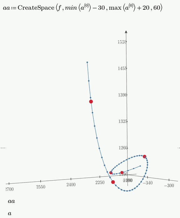

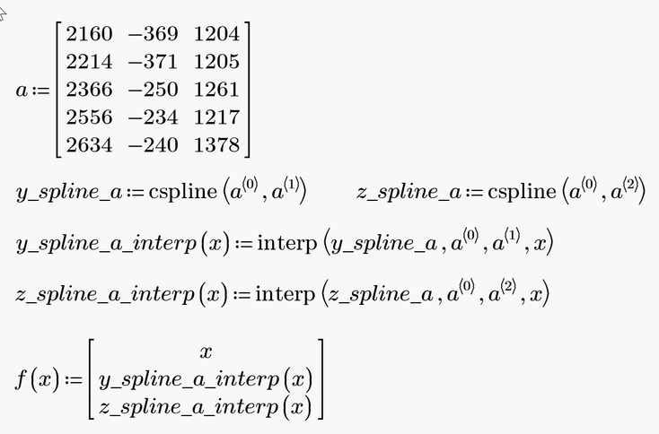

Personally I would have chosen a different approach without defining a vector for the x-values.

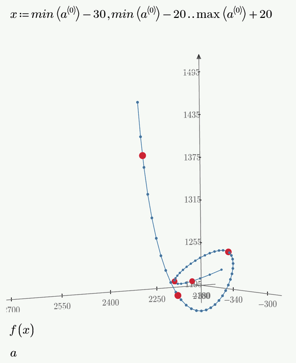

You may define a function f(x) which returns a 3x1 vector with the coordinates of the corresponding interpolated point.
Now you have two option for plotting the curve.
1) define a range for x (! similar to what you did) and plot f(x)
or as I would prefer
2) use Prime's "CreateSpace" function to do the job
P.S.: I would suggest that for future questions you say which version of Prime you are using - especially if you are not using the latest. This prevents that the answers you get are with worksheets you can't open.

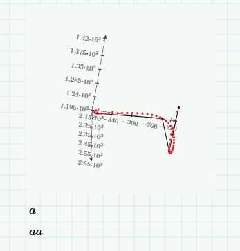

One additional remark: The method for a 3D interpolation of a couple of point you had chosen is limited. It only works if the x-coordinates of the points are strictly in ascending order.
A more universal approach would be to make x, y and z dependent on an (ascending) parameter t.
The choice of this parameter naturally also shapes the outcome! So you have to chose it depending on your needs.
In the pictures below you can compare the outcome if you chose the parameter as
1) the x-coordinate of the point (F, blue). this was your approach
2) a simple sequential numbering of the points (G, green)
3) the distance of the points (G2, orange); a quite common choice for the parameter
Prime 10 sheet attached
