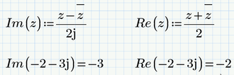

"Im" (lower case "m"!) is a normal function also available in Prime 7 which returns the imaginary part of its argument.
Im(2-3j) -> -3 and Im(123) -> 0
So asking for Im(...) not being zero means asking for a non-real number.
The pendent to "Im" is the "Re" function which returns the real part of its argument.
I assume you are using the full version of Prime 7 and not the limited free Express version and so "Im" should be readily available. Maybe you typed an uppercase "M" instead of a lowercase one? Names (functions, variables, units) are case sensitive!
In case you are using the Express version - "Re" and "Im" are functions which are not available in Prime Express but can easily be defined using the (available) conjugate complex operator:
