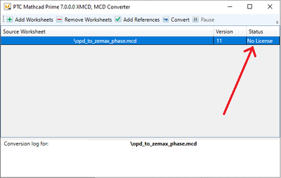

I'm trying to convert an old MCD file to the XMCD format -- but the converter fails with the message "Could not start mathcad conversion process"
How can I convert this file so that I can use it with 'PTC Mathcad prime' ?

If you are truly running Express--you're past the free 30 day full evaluation period, then the converter has been disabled; the message should read, "This is a premium feature, you have to give us money every year to use it."
For me it reads:
Yeah, me too,
But we know what they meant!  🙂
