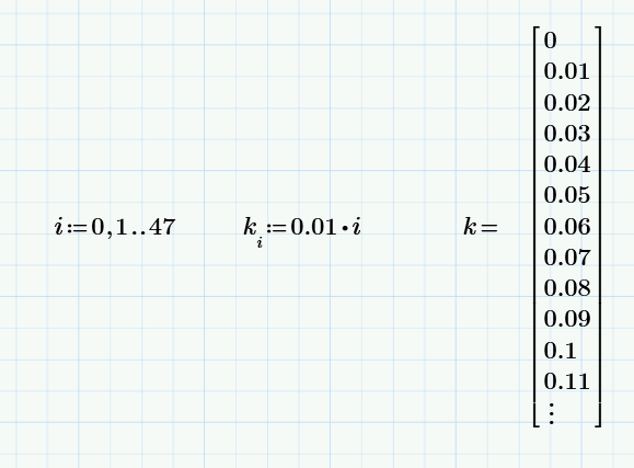

I have written a for loop code and I want to assign the final answer to a variable that is out side the code so I can use it else where in the program.
I have attached the file. The value returned by k is the final answer
Thanks!
LucMeekes
(To:Asad)
Make sure you have an index into the vector and plot it against that:

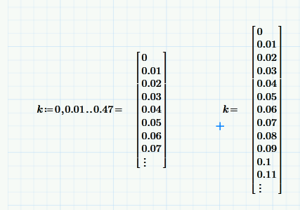

There's a better way:
LucMeekes
(To:LucMeekes)
And if you want it simpler, without explicitly defining a range:
(To:Asad)
Even simpler by using the undocumented trick to turn a range into a vector by using inline evaluation:

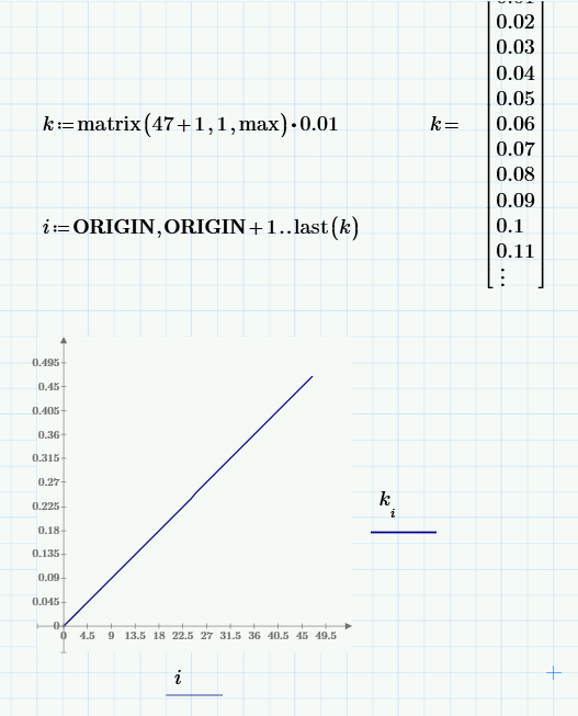

how do i plot this vector on a 2-D plot Thanks!
LucMeekes
(To:Asad)
You can also plot two (equal length!) vectors against each other:
