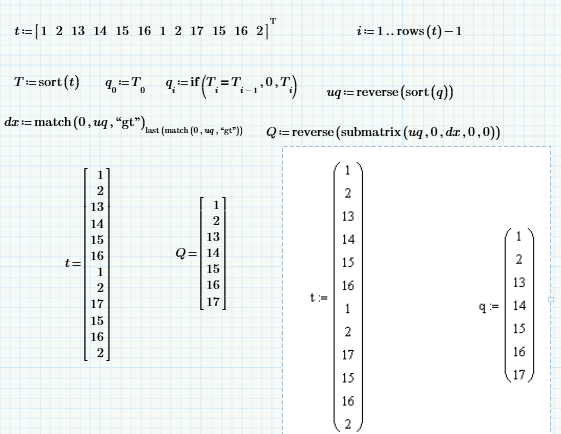

I would like to filter the repetitive values of the vector [t]  to form the vector [q].
The file in mathcad 15 is attached.

I'm using Prime Express, cannot program.  But you can still get there:
Prime 4.0 file attached
