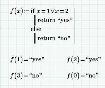

how would you do the following in Mathcad:
if  (x = 1  or x = 2)
     return "yes"
else
     return "no"
thank you.

exactly like you wrote it, but with "or" replaced with the OR operator. You'll find it in the operators overview, it looks like a large V.
