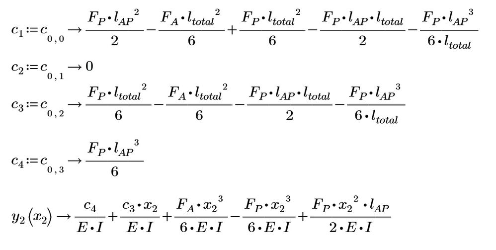

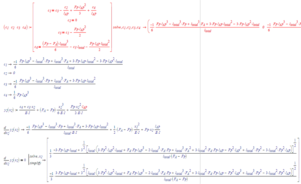

so im still working on this beam template and i keep bumping my head against the wall, now im trying to include those c.1 c.2 c.3 c.4  (that you guys helped me find. 🙂 ) in my final function

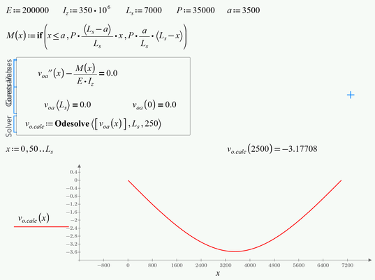

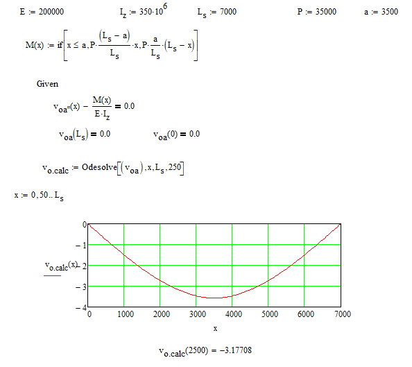

There is a better way using Odesolve() to solve the equation for deflection.
Beam of "Ls" span, of "E" material of "Iz" moment of inertia.
Point load of "P" applies at "a" distance from left hand side.
Beam is simply supported at each end.
This is a Mathcad 15 file and it does not convert well to Prime as the double dash in the solve block does not translate to Prime.
I am trusting the community can help with the translation of the file as it is a simpler solution to the problem.
Cheers
Terry

Here you are:
Worksheet in Format P5 attached
Here is the example with diagrams and words added.
Cheers
Terry
