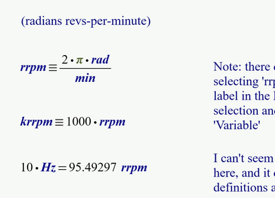

inconsistencies related to custom units, MCPv11
I am trying to use custom units in MCP v11. I have an included worksheet that includes a lot of domain-specific units and functions. This has been carried over from MCv15 and previous. I am now noticing that some of these definitions aren't working - I have distilled everything down to one simple example of success and failure, with no apparent reason why. See attached.

I had no problems to change the label of "rrpm" and "krrpm"from "Variable" to "Unit" via the menu.
But I remember that from time to time in the past I had a similar problem as the one you describe - changing the label via the menu did not work as the label would immediately snap back to "Variable" as soon as the focus was out of the region.
I don't know what caused that misbehavior.
But changing the label using the keyboard shortcuts always worked OK.
You can use Ctrl+Q to cycle through the seven label-types or you can use Ctrl+U to toggle between "Unit" and "Variable".

krs
(To:Werner_E)
Thanks Werner - I tried the Ctrl-Q/U trick and that worked - glad to know (hope I can remember) - I assume this is documented in help somewhere? As for the disabled regions thing - I agree, it seems that the red box is static once the definition is disabled. I also discovered a difference between the local and global definitions -see updated attachment.

updated file.
The weird thing is that when I reopened this doc I still saw the stuck label (stuck as variable) and several of you had no problem with this document. So it isn't the file itself??? Does that point to some system issue?

Not exactly sure what you mean!?
When I opened the first file you posted I saw that "rrpm" was labeled as "Variable" and so using it as unit when evaluating the 10 Hz failed.
I understood that you were not able to permanently set the label when you define the unit and I remembered that I has the same problem sometimes in the past. I can't say what causes that erroneous effect and why it was going away.
But the file you posted now seems to be perfectly OK.

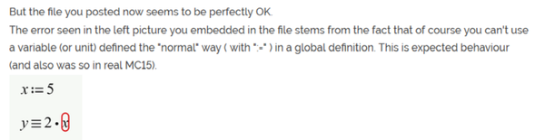

The error seen in the left picture you embedded in the file stems from the fact that of course you can't use a variable (or unit) defined the "normal" way ( with ":=" ) in a global definition. This is expected behaviour (and also was so in real MC15).

BTW, even though it possibly has nothing to do with your problem of not being able to set the label vie the menu, I agree with Stuart that its a good idea to avoid global definitions whenever possible. This was a good advice already for old Mathcad and still applies to Prime.

(To:krs)
@krs wrote:
Hi Werner, could you clarify please? something may have clicked in my head
Do you mean that anything with a global-equal assignment must be intrinsically defined? i.e. no dependencies on other variables?
When precessing the worksheet in a first pass only the global definitions are parsed. So when a global definition uses a 'normal' one,  it has not yet been processed and is therefore unknown.
A globally defined variable (or better: constant, as it cannot be altered in Prime other than via the API) can depend on others, but these must be defines globally as well (and above it). In fact you did exactly that when you (globally) defined the unit krrpm based on the (globally) defined unit rrpm.
On the other hand a normally assigned variable can use any globally defined one, no matter if its defined above or below it.
