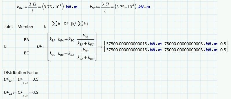

I want to
keep EI as EI in my calculations, as EI was defined previously. wondering if I can do that, and then I also want to extract 0.5 values out, because these are my Distribution factors. so I want to be able to type DF_BA = 0.5.

Can you please include your sheet so it is possible to show you.
Include DF:= before the matrix.  then DF_BA:=DF[0,2

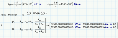

I will attach it here, when you look at my sheet I also want to set up the next matrix you will I have started working on it. I want to write the global coordinates and leave - signs as is even if i ^2 it. it will make sense in my sheet. I am new to mathcad so I am still learning this.

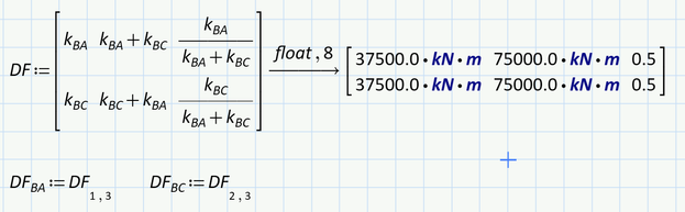

Are you looking for something like
And here what Terry suggested;
I guess you used symbolic evaluation because when using numeric evaluation (equal sign) the values are shown in Joule and the unit in the matrix can't be changed. I added the modifier "float" because its better looking with less decimals (default are 20 signinficant digits) and I thought you would not need that high precision. "float" should be used with care, though, because it does not only affect the displayed result but also the precision of the whole calculation!

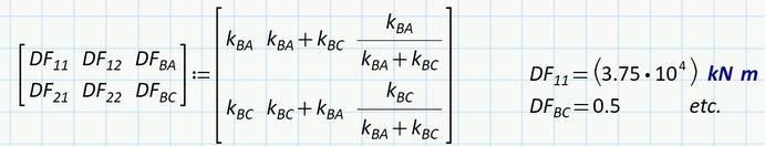

As an alternative, especially if you want assign the the other four values to some variables, too, you may use
I don't understand what you mean with your additional question, but looking at your sheet I noticed this:
You should avoid copy and paste as you may run into problems if you change some input values and forget that you have to copy and paste new results.
Rather use:
or even better
