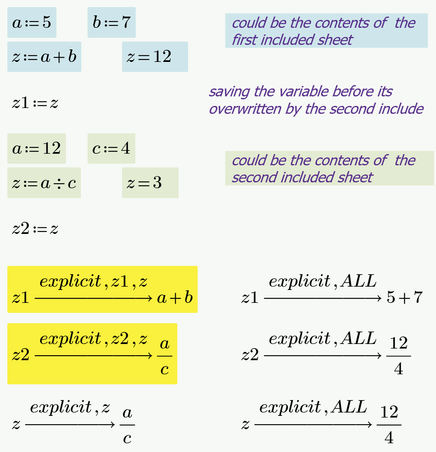

The 'include' facility is handling the included worksheet as if it would be part of the current sheet, as if the expressions in the sheet would have been typed in right at the position of the 'include' statement.
So the definition of Z1MP in the sheet referenced last would overwrite the definition of the variable with the same name in the first included sheet.
You could try to save the variables to variables of different names right after the 'include' and before the second 'include':
include "sheet1.mcdx"
Z1MP_sheet1 := Z1MP
Z1MP_sheet2 := Z1MP
To show the formula used to create those variables you still can use the "explicit" modifier but you have to specify both variable names, Z1MP_sheetx and Z1MP.
Example:
Z1MP_sheet1 := Z1MP
Z1MP_sheet2 := Z1MP
Example:
