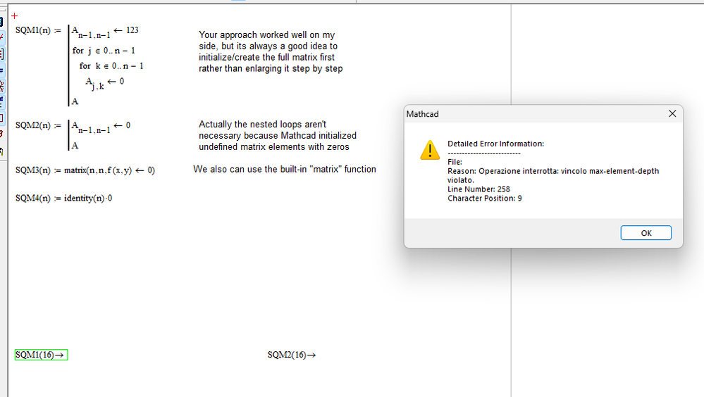

Good morning everyone!
I've been using Mathcad (now M15) for decades, but I've never seen an error like this. Could it be because I only have 4GB of RAM? I'm really not sure what to do. Thanks to anyone who can give me some good advice.
Regards.

BTW, the screenshot which shows the same error using my sheet - were you using my sheet unchanged? According to the error message the error occurs in line 258, position 9, which, if I am not wrong, is just after the definition (not evaluation) of SQM3.
No idea what would cause an error at this position.

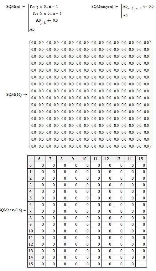

Try this file that does it OK. A0 matrix is only sixteen by sixteen that can easily be accommodated in 4GB.
Advantage can be taken of Mathcad's default actions.
a) Define last element in a matrix sets aside memory for whole matrix.
b) Defining memory sets 0.0 by default in each element.
I do not know why the presentation of the matrix is different.
Cheers
Terry

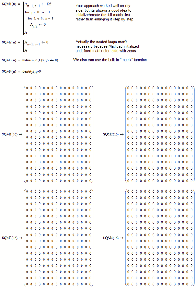

Here are some ways to create the zero-matrix and all seem to work OK in MC15 with symbolic evaluation on my side. File is attached.
EDIT: Just read that you experienced the same problem with Terry's file. So I assume that you will also have no success using mine.
Would be interesting if all my four functions would fail with the same error message.
My best guess is that something with your installation of Mathcad and its symbolics got broken. You may try reinstalling Mathcad. Don't forget to save your license file before you do so as I suspect that you won't be able to create a new one given that PTC has ceased support.

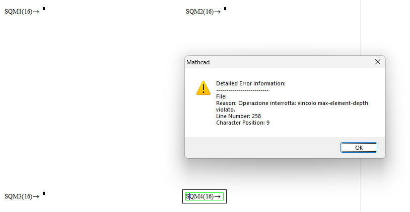

It gives me the same error:
A couple of things I would try.
Try changing the arrow after SQM1(16) etc to an equal sign so you are using the numeric not symbolic engine? That's the difference in presentation on my sheet.
Try deleting the program SQM1(n) and SQM1(16)= leave the other three? Then delete SQM2(n) if that does not work etc.

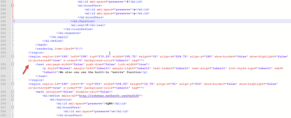

Can you include your worksheet so we can turn it into the underlying html and investigate line number 258 position 9?

Disable the evaluation of SQM1 and see if you get the same error for SQM2.
If so, disable SQM2-> as well and see if SQM3 works, etc.
This is to try if one of my four suggestions still works on your side.
I suspect that the error has something to do with the symbolic engine and will not occur if you use simple numeric evaluation.
Have you already tried to just numerically evaluate your function?
But I guess you have a reason for using the symbolics, don't you?
Another way to workaround this error (if you don't want to try a re.installation of Mathcad, as suggested above) may be to separate creation and display of the matrix. This is usually a good idea to do, especially when working with matrices.
Define M1:=SQM(16) and then evaluate the variable M1 = or M1->
Does this work OK?

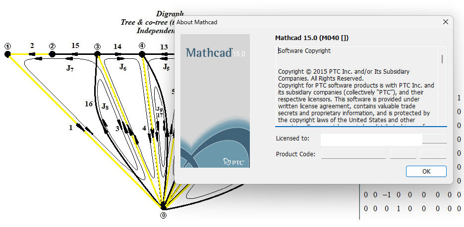

BTW, which maintenance release of Mathcad 15 do you use? The latest is M050 .
You can check if you go to "Help" and choose "About Mathcad...".
According to the docs there was an error in Mathcad 15 M040 (and maybe also below) which was fixed in M045:
"2879283 Fixes issue with Mathcad 15.0 M040 in handling matrices with 256 or more elements"
In the 'Readme' of MC15 M050 I also see a bug which was already fixed in M020
"2048135 Fixes an Out of Memory error for specific symbolic calculations"
But I would guess that this is snot related to your problem!?
SQM is just a little program I used to see if the error persisted outside of a worksheet of about 8 MB in which I make extensive use of matrices (in this case 20 x 20 symbolic matrices) and algebraic operations on them. When I saved the worksheet, there were no problems. When I reopened it, the matrices (20 x 20) and other data simply disappeared, and that message appeared. I've been using Mathcad 15 installed on this backup PC for a few days now, since the other PC is down, and I didn't expect to run into such a problem. But the copy of Mathcad 15 that is installed, I think is the same one I used on the other computer without this problem, or perhaps I updated it but I don't remember when. How do I fix the error indicated in document 2879283?
