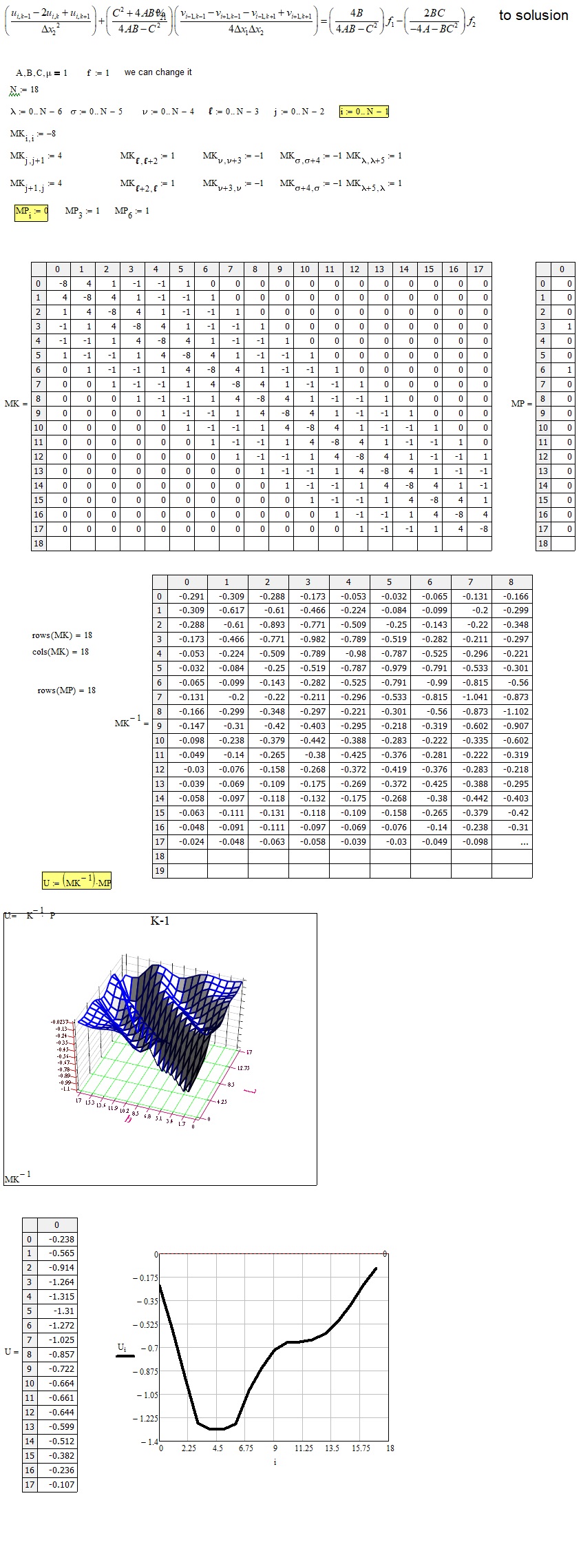

please try to find solusion of the problem in attachament. Please solve it for coefficients A B C f v = 1. I tried write the matrix but i've could not. Please help write correct matrix for my problem and then solve linear it. The matrix i the importantiest

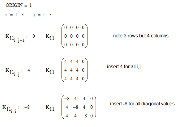

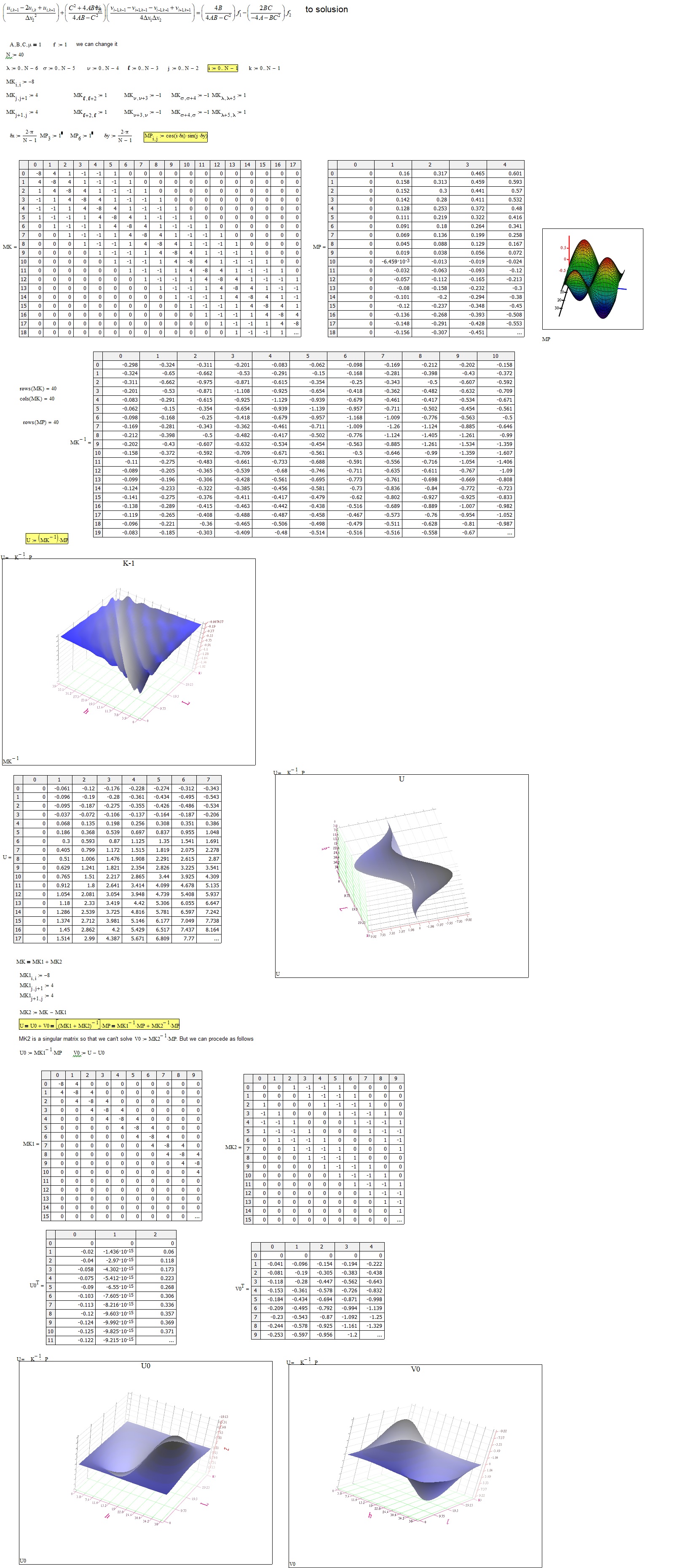

Couple things:
Mathcad considers that array and matrix indexes start at 0 by default.  You change this with the system variable ORIGIN.
The order you do things makes a difference.  I've put in a small example (3 by 3 instead of 440 by 440) to demonstrate:

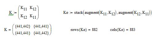

I think for matrix K you intend to assemble as one large matrix, but you have made a nested matrix.
This shows how you assemble a larger matrix from four smaller ones.

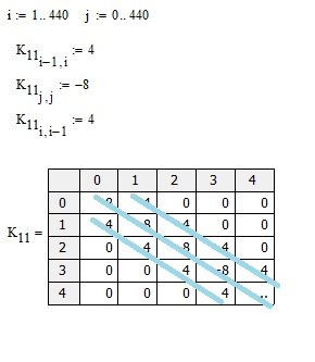

By chance, is the K11 matrix tridiagonal? that is:

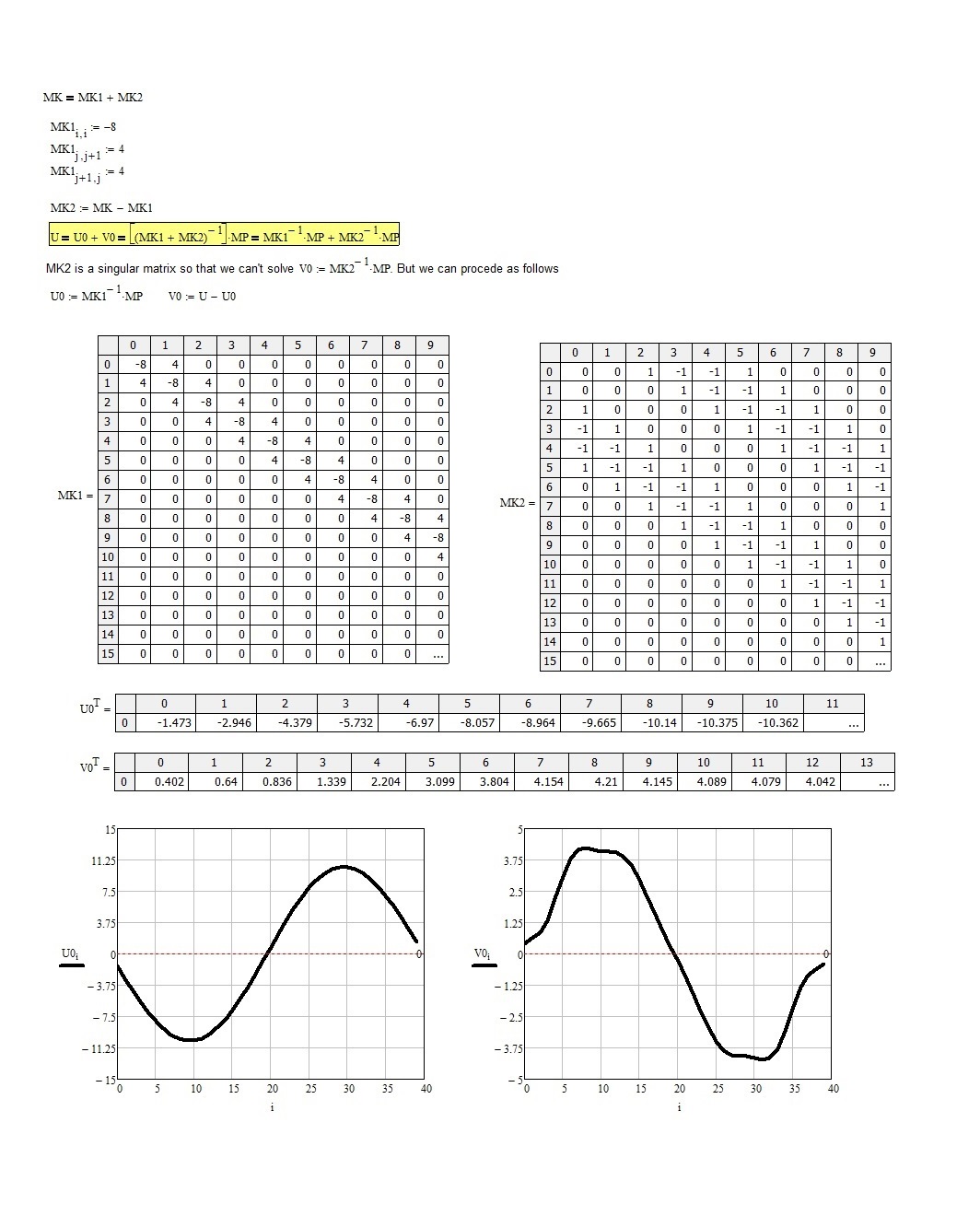

-MFra-
(To:ptc-3682623)
I could hazard this solution ..... but it is completely heuristic ....
ptc-3682623
(To:-MFra-)
Hello, wow, great job. Would you compare solution in two case. For me is not the same. Is possibility draw  a graph u,v in 3d?

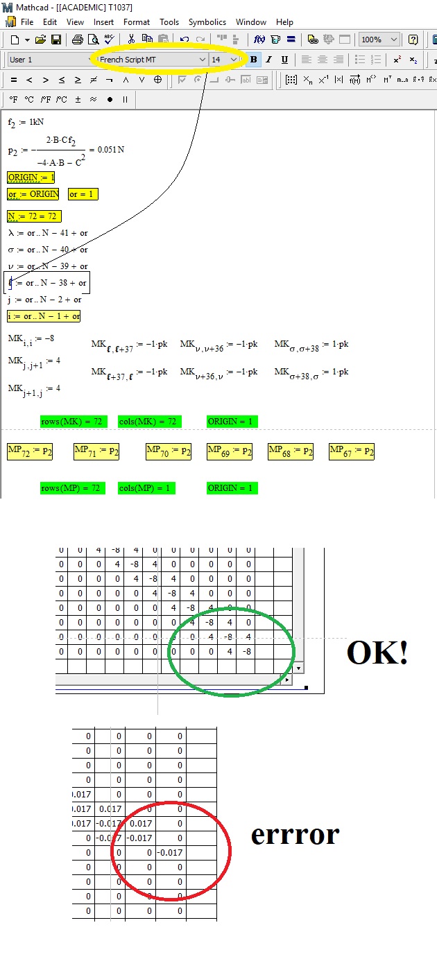

Hi. I could not have solved my problem. In attachment you will find a sample of shield. I discretizationed it and for it we have model of finite difference method the same like last time. for point 3 - u,v=0 for point 28 - u,v=0. For point 5,10,15,20,25 - right site of equation is 10. Please help.

ptc-3682623
(To:-MFra-)

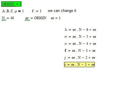

I ve done some. I do not know why i have 74 x74=K we need 72x72 and order are the same like in sample. positions 36 of v are ok. this means 36 u and 36 v from beginning 1,i and i,1
LucMeekes
(To:ptc-3682623)
You've set N:=72, and you let j run from Origin to N+Origin (that's up to N+Origin=72+1=73).
Then you index MK up to j+1. That makes 73+1 =74 maximum.
