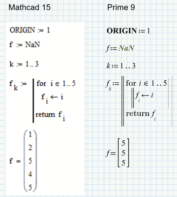

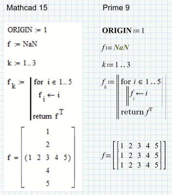

(To:MeekesLuc)
@MeekesLuc wrote:
This apparently is a detail difference between Mathcad and Prime.
In my opinion the behaviour in both versions is somewhat strange and not as it should be.
I would have expected a matrix with all elements being of the same value ...
Here are two examples where Mathcad returns a strange/wrong result, but Prime's result is exactly what i would expect:
Of course both also are examples of bad programming style, but using the same name for the worksheet variable and the local variable should not pose that problem.
