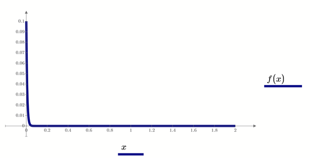

The differential equation:
Has solution:
Now with:
we know c also.
So:
We can compare the numeric solution
with the exact solution:
The difference is:

Forgot to mention that in case you are using a current version of Prime, the ODE can also be solved symbolically
It also looks like we could add an initial condition
But the first attempt using a numeric value failed
Using 1/10 instead of 0.1 does the trick:
Using the prime symbol for the derivative you may even omit the function argument x, but I won't suggest doing so
