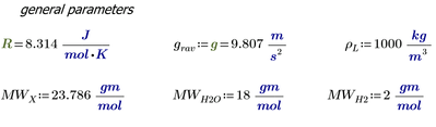

- You define at the top:
Then what do all these constants 9.81 in the formulae? And did you know that g (by itself) is a predefined constant in Prime?
Ah, the predefined g has units, and you work without units. You can define your variable g.rav := g/SIUnitsOf(g).

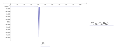

- Finally you arrive at a certain function F(). Note that it is different from the right-hand-side of the differential equation you have just above "Solving the system". Other than that, if you plot that function for the middle value of your proposed range for H.L, with
you get:

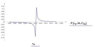

If you plot it over the proposed range for H.L with the first value of r.B, you get:
Now both sorts of behaviour of such a function are not going to make Odesolve happy.
