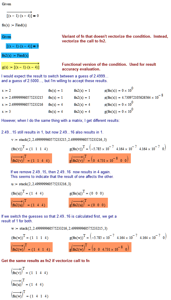

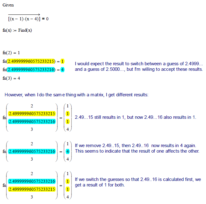

While playing around with this, I found something odd.  Any thoughts?  For reference, this is using v15.

Your solve block is trying to make the vector of results equal to zero and not just each individual value. It would seem as though the solver steps don't bring it close enough to the 'correct' solution when it's trying to get all of the solutions in one hit.  Vectorize the call to fn to get the results you are expecting.

In my Mathcad document, I called the fn functions with 4x1 matrices as the argument - as shown in the image I included with my post.  However, after saving the file and re-opening it (or if you open the file that I attached above), the functions are called as if the four matrix elements were four separate arguments.  What caused this?

Yes, Don't Know what caused it but I did notice it when I opened your file ... I was rather wondering why I could only see one set of parentheses/brackets on your image. I was expecting:
(I've used the Prefix operator in the second case to evaluate the expression, but there's small gap between fn and the vector that isn't present in your image and that made me think you hadn't used it)
It was just easier for me to stick a stack around the fn argument than convert back to vectors.

You're right: using only one set of brackets caused the issue.
Obviously it's not useful since you can't save it this way, but to call the function with the one set of brackets:
- Enter the function as you show above with two brackets
- Delete the outer set of brackets and subsequent empty placeholder (place courser to the right of "fn" and hit delete twice).
I did this to give it a "cleaner" look (subjective, I know).  I could swear I've done this before without problem.  I'll have to see if I can find any old examples because I tried a few methods and can't get anything to work (not that it really matters anyway, though).
