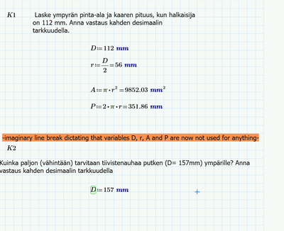

Is it possible to reset variables? For example, if I want to have one file with multiple different calculations inclduing a variable for diameter, is it possible to have a line break or something, so that any variables above it are not used? Therefore variable for diameter needs to be redefined again.
I know that just re-using the same variable redefines it, and that I could use D, D_1, D_2 and so on, but I do not find these acceptable solutions as it increases potential for calculating errors.

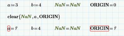

Unfortunately any form of ALL, or * doesn't work to clear all variables.
Note that you can clear ORIGIN, but you cannot clear NaN:
Interesting!
I did not expect to be able to 'clear' NaN  as NaN is used wherever a number is valid and you can't clear a number either..
