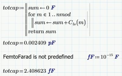

Programming commands like return may only be used inside a program block, not on worksheet level.
Its not necessary to define a range variable m. In a program a for-loop does the job:

maybe I solved with the attached file, just using the sum function. Is it correct?
(To:rmarcelli)
Yes, its correct and sure a very compact way to do the job (compared to the manual sum programming a sshown in my prior answer).

Thank you Werner. Actually, as my past experience is mainly on classical programming I tried to follow simple methods for simple questions.
Thanks, by the way, for the definition of "fF", as it is not defined by default.
