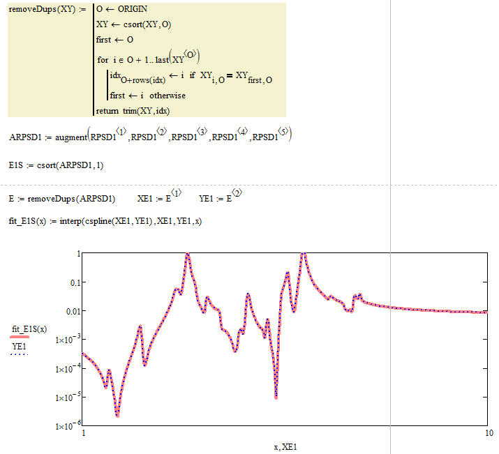

I have been trying to do a cubic spline for on a mechanical spectral response. Unfortunately the spline does not work, can anyone explain to me why is this happening?

Best answer by Werner_E
Here is a quick solution.
A routine which sorts and removes lines in a matrix when the elements in the first column are duplicates.
Only the first line will survive. A more sophisticated approach maybe would average the values in the other columns rather than throwing away all but the first.

The problem is, that you have a lot of duplicate values in your abscissa vector XE1 and thats what Mathcad's spline interpolation chokes at.

Thank you all!
Werner! Thats amazing. Thanks!
