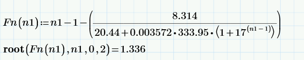

how to solve this equation to define n1 by using successive approximations in mathcad
[1.34 .. 1.42]
a=20.44
b=0.003572
ε=17
Ta=333.95
n1 - 1 = 8.314/(a+ b*Ta (1+ ε^(n1-1)))
[1.34 .. 1.42]
a=20.44
b=0.003572
ε=17
Ta=333.95
