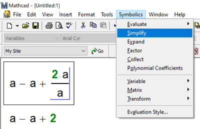

We can do so in Mathcad 15
Do its in Prime!
