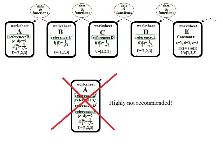

-MFra-
(To:ifomenko)
 have you fulfilled the following rules?
furthermore there must be no redefinition of functions, variables and constants in each worksheet.
Create daily copies of the main worksheet and possibly of the other files as well.
