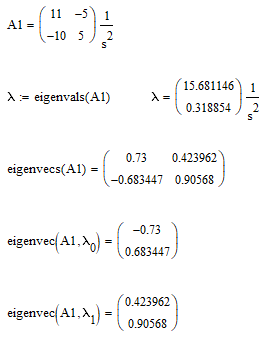

On contrary to the Eigenvalues, Eigenvectors are not unique. Every multiple of an Eigenvector is again an Eigenvector corresponding to the same Eigenvalue. This said you can always multiply each Eigenvector with the sign of its first component. This will always make the first component positive.
The order of the Eigenvectors given by "eigenvecs" may not correspond to the order of Eigenvalues returned by "eigenvals" (actually I am not sure about that). To be on  the save side you can use "eigenvec" (without the trailing "s") to give you an Eigenvector for a specific Eigenvalue.
I am not sure why the signs of the components of the first Eigenvector is different from the one given by "eigenvals", but of course both are correct and valid.

I edited my first reply in the meantime and attached a screenshot showing what I meant by multiplying by the sign of the first vector component.

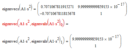

Can you post an example where "eigenval" returns a wrong result whereas "eigenvals" doesn't?

If you come across a specific matrix where the results of "eigenvectors" and "eigenvector" differ, I would be interested.
I tried a few matrices with small values but never came across any significant difference (apart from expected rounding errors).
Here's an example
We can also compare the results of symbolic evaluation which give us a different, but equivalent set of eigenvectors

i added some comparisons at the end of the file. there are four examples in the file. you have to rearrange them to see a given example. some compare ok some don't and quite a few fail to generate a result. that's why i went with eigenvals and eigenvecs. they were consistent and compared to fea. all the rest had various issues.
i don't know what's going wrong with eigenvec. that's the worst offender. maybe i'm doing something wrong there.
Update; I think I messed something up. I attached a corrected version. However, the problems I were mentioning are still there.
It looks like the pink example is the best one to use, to show the problems. That shows errors with genvals, genvecs, and eigenvec
I see!
The matrix
seems to push Mathcad to the limits of its numerical capabilities.
Its interesting to see that "eigenvecs" still returns results, while "eigenvec" fails.

i'm glad you can see the errors now. even for normal inputs (the blue and green examples), eigenvec fails. is there something i'm doing wrong there, or are you getting the same problems? it says it's failed to converge.
I experience the same error message. I guess the reason is the high values and that they are very similar. Even though because of the large numbers the determinant of the matrix is around 10^26, the elements in the matrix are very similar, close. So I can imagine that an algorithm may fail here as the determinant can be said to be close to zero in relation to the maginitude of its elements. I am not surprised that "eigenvec" fails but I am surprised that while it fails "eigenvecs" does not. I wonder about the different algorithms used behind the scenes.
