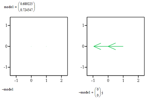

i seem to have run into a bug with mathcad 15 plotting. i'm sure there is a way around it. however, i don't know how to do it. i put the question in the file. it's near the bottom of the file. i think there needs to be an if statement that checks to see if both elements of the matrix are negative. if so, make them positive. the matrix with the problem is called 'mode1'.

According the vector field plot you are using: I am not sure what you think its showing?? You may look up the explanation of the vector field plot in the help to see what kind of data structures it expects as its input.
Your vector is interpreted a a vector of complex numbers, where the real part represents the horizontal and the imaginary part represents the vertical direction of the arrow. The starting points of the arrows are always the row and column numbers.
For some reason (I guess its a bug) this does not work if both numbers are negative. Strange enough it helps to simply add an "imaginary null vector".

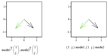

If your goal was to plot the two Eigenvectors, both starting at (0;0), you could do it that way:
EDIT: Could be a bit easier achieved by one of the following ways

unfortunately eigenvec and the other function i think it's genval genvec. they all randomly fail depending upon inputs. the only function that worked for all the test cases i ran was eigenvecs eigenvals. there just seems to be some sort of plotting bug if both entries are negative. the plots duplicate something i'm testing in fea software. so i know what they are showing. i already got the sorting worked out based on a decades old post. i just tweaked a few things to get it working with v15. i'll try to apply what you are saying about flipping the signs. i'm still confused on how to do that. it will plot if both are positive or one is positive and one is negative. it won't plot if both are negative. it would be fine to always make it positive. the only problem is i can't just do an absolute value because sometimes one is supposed to be negative. so that is where i was thinking an if statement would be needed.
I edited my first reply in the meantime and attached a screenshot showing what I meant by multiplying by the sign of the first vector component.
I also added a workaround which makes your plot work in case of two negative numbers (adding the imaginary null vector).
You may ignore my last remarks about plotting the vectors if what your plots show is already exactly what you are looking for.

the trick with adding zero imaginary values should work. thanks a lot. i attached an updated file, with that fix. for anyone else reading this, make sure to type 1i or 1j to get the imaginary number to work. i was stumped for awhile with that. typing just i or j does not work. it says as much in the help.
