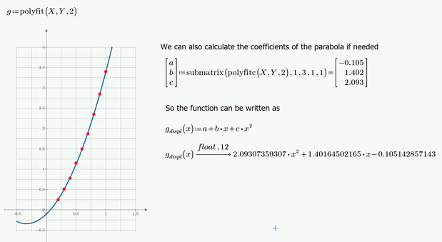

Possible. I thought he would like to fit a hyperbola and as I already indicated I think a hyperbola would at least need some sort of horizontal displacement (B) and better also some vertical displacement (C) - and of course scaling (A).
But a polynomial fit of order 2, a parabola, seems to do a good job as well
Comparing the sum of squared errors we see that the hyperbola offers just a very slightly better fit

You may either set up a solve block with "minerr" , minimizing the sum of squared errors, or, more convenient, use the "genfit" function. Look the latter up in he help.

Attached is my least squares fit to a parabola. The hyperbola fit is included but fails. (Well, you get a fit but if you look a Werner's function you can see why there's no success--I've got the wrong form of expression. Adjusting the formula (and stealing Werner's value for B) has been included.
File is Prime 4, readable in any Prime greater than or equal to 4.
