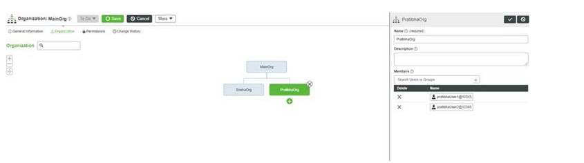

Now to control the visibility of context follow below steps:
  1. Create an Organization say “MainOrg” and add two sub units under the MainOrg.
  2. Create 4 users as “Maintenance manager or any” and add 2 users in each sub unit organization.
        3. Create 2 network for each context view and add 1 or more line & assets in the network
        4.  Go to the visibility permission of the first network and add one sub unit organization & give run-time access to the users or user group specific to that organization.
        5.Repeat the 4th step for second network.
        6. Go to launch point Configuration & create context for 2 different networks.                                                                            7.      Go to PTC.SCA.SCO.ContextManager & execute PropagatePermissions services according the requirement like PropagateUserGroupPermissionsOnEntities, PropagateUserPermissionsOnEntities.
