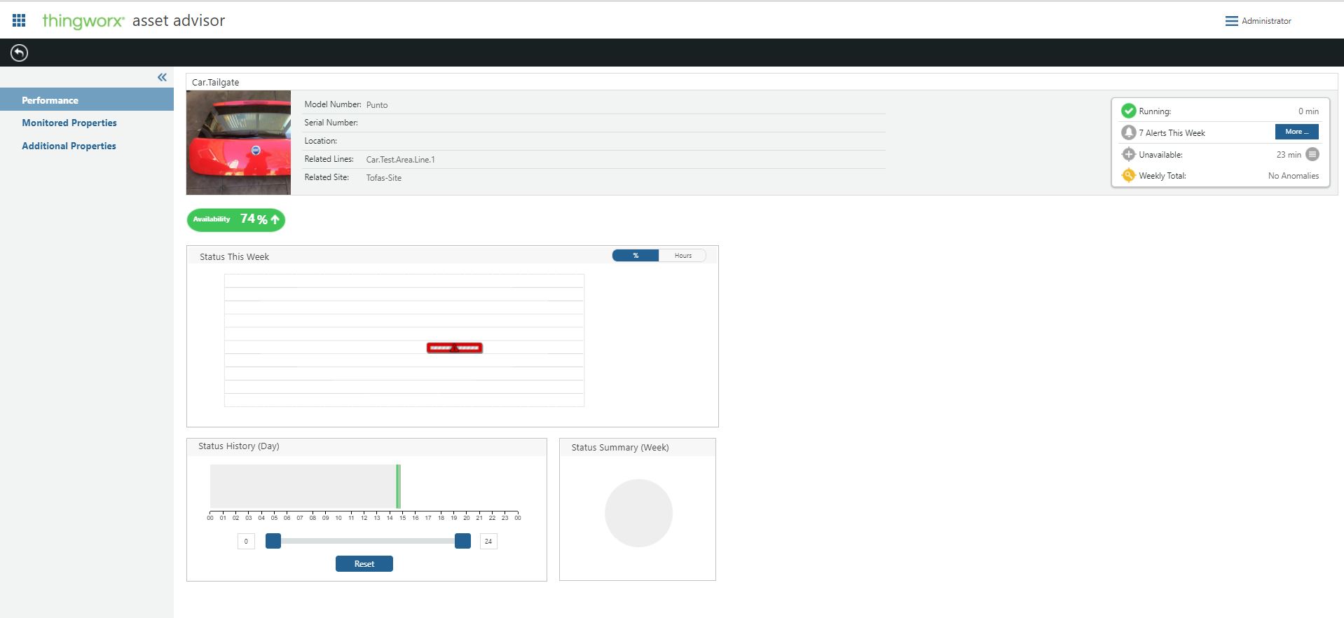

Hello Everyone;
We are using ThingWorx Manufacturing App and so far we can successfully connect to KEPServerEX and fetch simulated data properly. Alarms also works fine. But in Asset Advisor -> Performance Tab, there is "Status Of Week" section which does not working at all. % and Hours sections both are not getting any data.
Any suggestion will help.
Thank You.

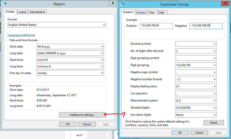

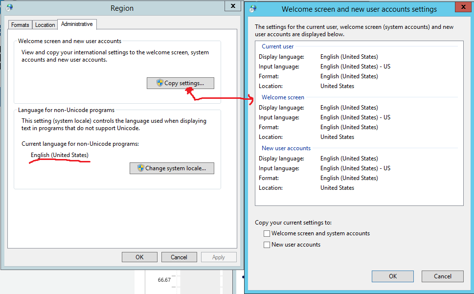

It's allready working. I was using "," as decimal separator as you said. So I switched format of date and also "Language for non-Unicode programs" to English. Then I reinstalled Thingworx and KEPServerEX and it's working now.

Are you logged in as Administrator or a user you created?  If you try under Administrator, do you still get the same results?

Please check to see if the properties are defined with a Base Type of INTEGER.  If so, change them to Base Type of NUMBER.  If this does not resolve the issue, please provide the application log for analysis.
--Sharon
By looking at your screen shot, the status this week chart widget is not pulling the data. I see an error. I also see Running as 0 minute. Can you try this after few minutes allowing machine to do calculations?

I am pulling data from KEPServerEX Simulated data. In KEPServerEX property there is no integer section so i give a Float value which works fine with other wigdets. Alarms also works fine too. I can make planned or unplanned stop by giving boolean datas manually from kepserverex. But status of week just wont work at all. Its a demo version of TMA. Perhaps not all the functions available for demo app.

This version is good. By looking at the screen shot and other information in it, that data is flowing from Kepware. I still see error icon in Status of the Week. Instead of % tab in Status of the week widget, can you select Hours tab and check? It looks like some error in binding the widget. As Milan was asking, the type of licensing such as Freemium, Dev kit or  Add-on to Thingworx will help us to determine the next step. Probably we may need a session with you debug this.

I have the same problem with "Status This Week" indicator.
I'm using KEPServerEX 6.2,
ThingworxManufacturingApps 8.0.0 (developer kit) and
DemoSimulatorPackage
Everything works properly only "Status This Week" indicator doesn't work.
Have you already solved this problem?

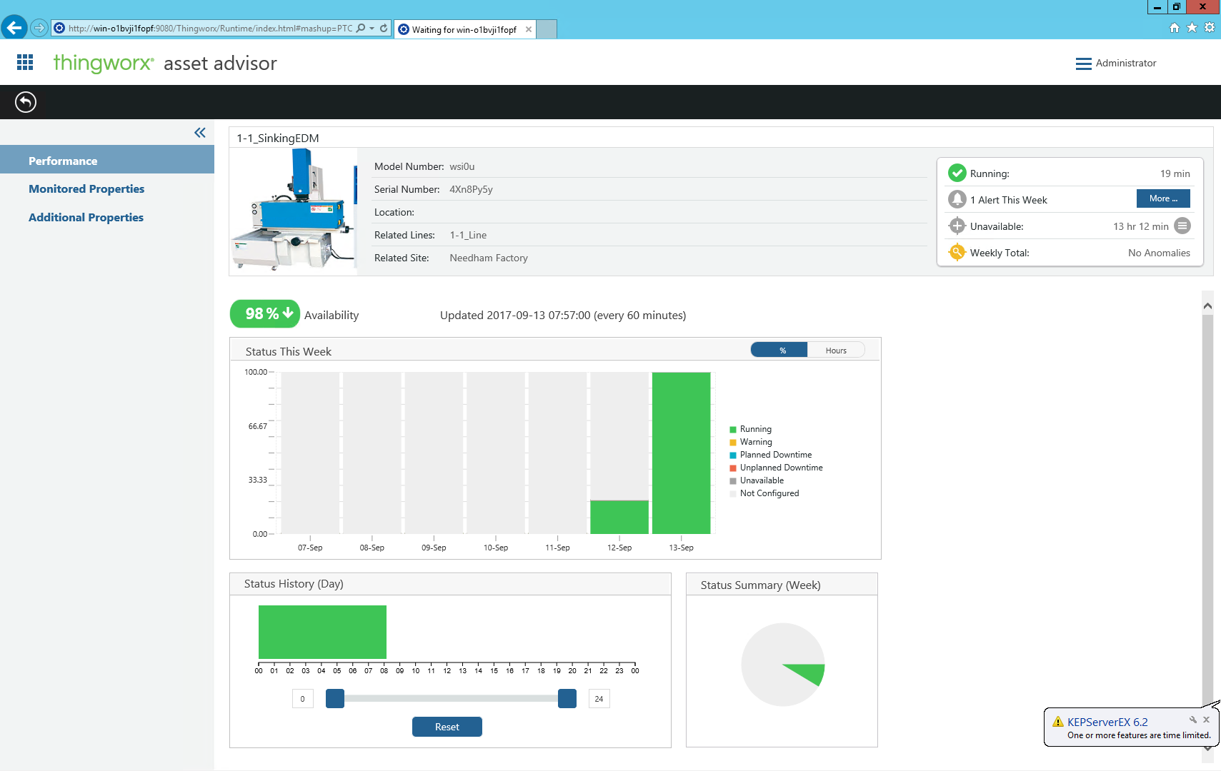

I hope language does not matter. Are you using Comma as decimal separator? Can you open the PTC.SCA.SCO.AssetMonitor.AssetDetail.PerformanceMonitorController Thing and run the service GetStatusHistoryForPastWeek? You can select any Asset you configured as input. The Boolean input doesn't matter in our case. Can you post the output?

Murat Can Berber​ and Ozgur Aslan​, can you try following the steps described by Stanislav to change the Windows' language settings? In particular, set the decimal separator as a period instead of a comma, and set the "Language for non-Unicode programs" to English. You will likely need to reinstall ThingWorx to get these new language settings to be fully adopted by the application.
Varathan discovered what may be an issue with how the floating point values are being parsed into a data table, with a comma specified as a delimiter. For OS language settings where the comma is used as the decimal point, this will cause the floats to be incorrectly separated around the decimal point.

I tried all the steps that Stanislav described, uninstalled everything and installed again, but problem was not resolved.
Anyway, changing the local settings of OS is not the correct solution because me and my customers live in Turkey and need to use local settings. I can't offer a change like this to anyone.

Thank you for your feedback. Yes, agreed-- adjusting the OS language settings should not be a requirement for the mashup to work. The objective now is to find a short-term workaround for you until we have a more permanent solution available.
Please confirm, did you also test setting the "Language for non-Unicode programs" to English, as well?

I switched to another laptop to setup Manufacuring Apps from scratch. After confguring everything as Stanislav described, the chart worked well as you can see below. Thanks everybody!
