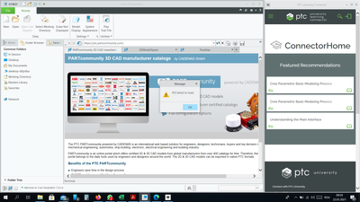

hello
i instaled Creo but it didnt work
Sir/Madam,
                   I have downloaded and extracted the files, started the installation. At the simple license entry I copied the product code from the given pdf and pasted in the space, also login done. But the 'Next' option is not activated and I can't proceed further. So, please help me to install the software.

Try typing the code, and check for the message under the product code area (Success or Error). If the message is a red Error, hold the mouse over it and it will tell what the issue is.
