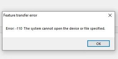

Issue:
"Error:  -110 The system cannot open the device or file specified" while installing Creo Trial version
 Reasons/Causes: -
  • The Installation “PTC Creo Parametric 8.0.0.0 Trial CloudPlay.exe” file does not exist.
  • Antivirus software is preventing the file from being installed.

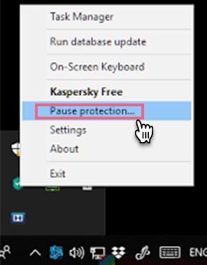

Solutions: -
  • Disable any security software on your computer and run the installer again as administrator (Refer below Image)
  • Clear out the temp files from the system navigating to below location
    • C:\Users\ (User Profile) \AppData\Local\Temp
  • Download the installation file PTC Creo Parametric 8.0.0.0 Trial CloudPlay.exe again and Run as Administrator
