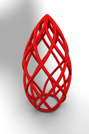

Seeing a picture of 30 St Mary Axe, widely known as The Gerkin building in London, i wondered how the frame could be modelled in PTC Creo.
A few minutes of observation followed by some fiddling came up with right and left handed helical sweeps patterned around a common axis. A revolved ring connects the ends at the bottom. See if you can come up with another method of modelling the frame.
The PTC Creo model is attached. Does anyone with a 3D printer fancy printing one and posting a picture?

    Very nice Tim.  An interesting application of the Helix featuring command.

    Hi Tim,
    and Bob
    challenge accepted and printed,Scaled down a bit for quick print but still looks good, very impressive, thanks129.JPG

    Wow! that was fast and for once lives up to the term 'Rapid Prototyping'.
    Out of interest, what was the material cost?
    Thanks for going to the trouble and posting the picture.

    Hi Tim
    material cost on this was 12p, as I said I scaled it down for a very quick print, so material wise it was negligible. Even the full size only works out at just under a pound.
    Jeremy
    ps. if you would like I can send you a copy

    I've had an Ultimaker 2 3D printer on loan for a couple of weeks and decided to try this model.  The build time was just over two hours and it was fascinating to see the spiral arms growing without any support!
    Video Link : 5853
