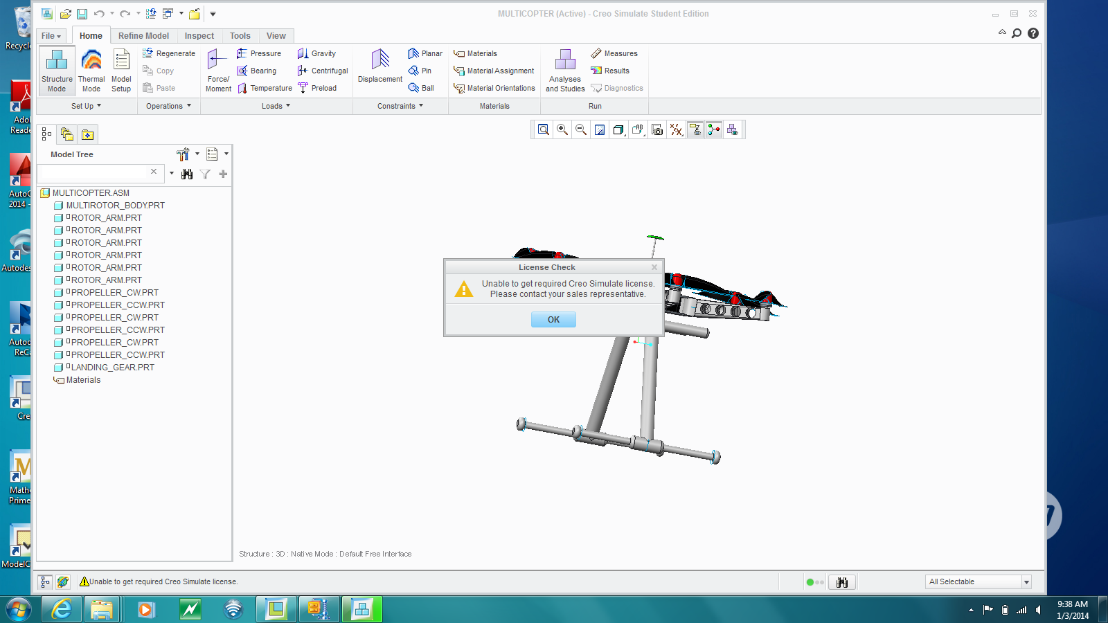

Hi everybody. I am part of my school's RWDC team, and am having trouble fully opening the RWDC parts files on Creo Simulate 2.0. When I open the assembly of the model, it gives me a message that says, "unable to get required Creo simulate license. Please contact your sales representitive."
Do I really need to contact a sales rep? Or can I fix this by myself ? Thanks.

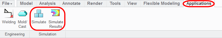

Hi Christian,
For RWDC you will be using the embeded version of simulate which is within Creo Parametric. Just open up you rmodel in Creo Parametric and go to the applications tab. All the simulate tools that you will need will be there.
Let me know if you have any questions!
