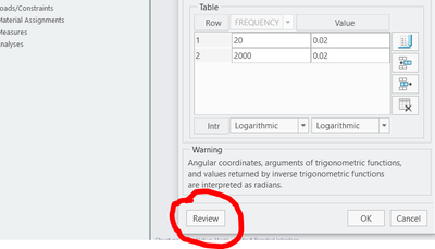

- I’m applying an enforced motion (base excitation) on the constrained rail surfaces, simulating the shaker input. Is this the right approach for replicating a vibration test inside a deployer?
- I used weighted links to connect the point masses to the payload mounting holes. The holes are not constrained (only the rails are). Is that correct, or should the payload attachment holes be constrained too?
- For the PSD table, should I use linear or logarithmic frequency spacing? The vibration profile is based on a launcher-provided spec. Where should I insert the values to get the results? (I pressed on f(x) under PSD and created my table with the launcher values. Is this the correct way?)
- Any other best practices I should consider to obtain valid results?
Unfortunately, I can’t share the actual files, but I’m happy to describe my setup further or provide screenshots of the model and settings if needed. I would really appreciate some step-by-step guidance on how to properly fill in the required inputs when creating the Random Vibration study in Creo.

PSD Table — Linear or Logarithmic?
For launch vehicle random vibration specs:
Almost always use logarithmic frequency spacing ( I am not 100% sure , I did some research)
From Research:
"Launcher PSD profiles are typically defined in log-log format:
  • Breakpoints at specific frequencies
  • Slopes defined in dB/octave
  • Constant PSD plateaus"
In Creo:
  • Using f(x) and entering the table manually with the launcher-provided frequency points is correct.
  • Enter exactly the breakpoints provided in the specification.
  • Do not over-interpolate unnecessarily.
Tip: Use Review to generate Graph of your inputs
So yes to your question
Using f(x) to input the PSD table is correct.
 Enter launcher spec values exactly as given.
 Logarithmic interpretation is appropriate.
