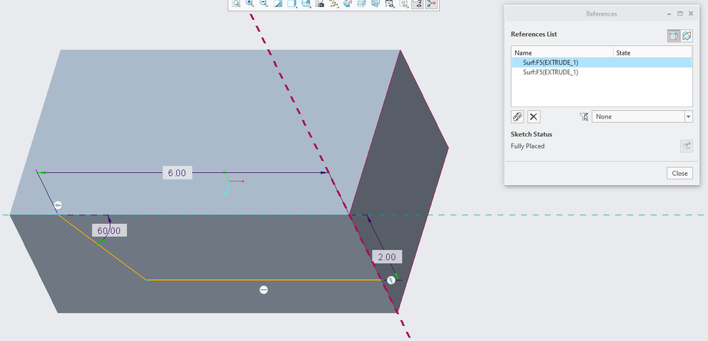

Starting from the attached box, having dimensions 7,4,3 mm, I want to use either Blend, Variable Section Sweep with two trajectories, or Extrude up to a datum plane created by specifying three points, to create the attached extruded part, with the dimensions specified in the image.
After going over quite a few tutorials, I still have no idea how to approach this question. Is there any chance you will be able to guide me through the process using each one of the methods I mentioned? (i.e. Blend / Variable Section Sweep / Extrude)

Thank you so much Martin! Is there any chance you'll be able to upload the video showing the first two sketches (or maybe look at the attached video)? My problem is that I am not able to specify the length of one of the lines to be "6" without creating a line there (and as you can see in the attached video, if I do create a line there, I have a very ugly additional line that doesn't appear in your video).
dimension 6.0 ... I created it manually by selecting endpoint of line and side surface
dimension 2.0 ... I created it manually by selecting horizontal line and top surface
dimension 60.0 ... I created in manually by selecting top surface and short line
I see. The problem is that Creo doesn't let me choose the line endpoint and create another dimension out of it and the other surface.

set top and side surface surfaces as sketcher references (see my last picture again) and use these references when dimensioning.
