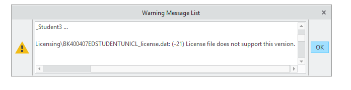

I installed program normal, tried to run it and it was problem with licence. I red some of the conversations here and I uploaded the licence again. The message shows that this licence doesn't support this version. Please help!

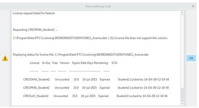

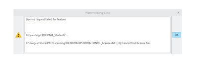

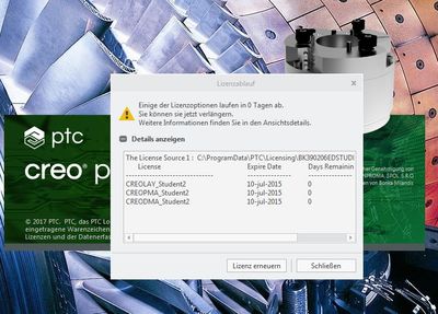

I can not remove the old licence from Creo 2.0 on my computer. The folder is empty: C:\ProgramData\PTC\Licensing, but the licence from 2015 ist present.

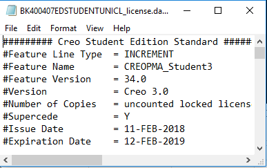

The new licence is installed successfully.

I've already solved the problem. The solution was to delete all files from this path C:\ProgramData\PTC\Licensing. After that, I installed Creo again and the licensing works fine. Thanks for your help anyway!
