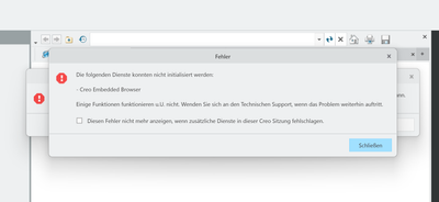

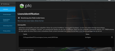

Hey everyone, I just signed up for the Student License, but unfortunately, the license file came without any information on how to proceed with it. I saved the file under Programme Data /PTC/Licensing, and added the license path in the setup wizard. But when I open Creo, only the free test version gets opened (which does not work either, because the embedded browser couldn't be initialized).
I tried to use the product key of an old Creo version (4), but this does not work for Creo 12. Could anyone help out with the product key for the student license of Creo 12?

Edit: I resolved the issue by simply adapting the product key for Creo 10.
