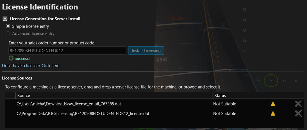

my trail license has expired, but i forgot to change in to student edition license. How can i get in to student edition?螢幕擷取畫面 2025-11-26 234155.png

below you can find some information. Hope it helps you.
1.]
BE120908EDSTUDENTEDK12_license.dat contains locked license. This means you do not need to install FLEXnet license manager.
2.]
In existing installation you can find parametric.psf file located in Parametric\bin subdirectory.
You can edit parametric.psf file in Notepad.
In you case the file must contain two following lines:
ENV=PTC_D_LICENSE_FILE-=C:\ProgramData\PTC\Licensing\BE120908EDSTUDENTEDK12_license.dat
ENV=CREOPMA_FEATURE_NAME=CREOPMA_Student6 ()
Please check, whether INCREMENT CREOPMA_Student6 does exist in license file.
