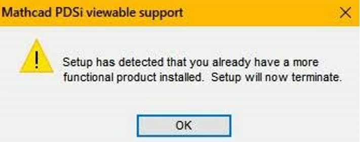

Error message "Mathcad PDSi viewable support: Setup has detected that you already have a more functional product installed." is displayed during the installation of Mathcad
Cause:
System has advance PDF reader already installed
Resolution:
  1. Mathcad PDSi viewable support is only required for integration of Mathcad with Windchill.
  2. Users can ignore this message and continue with installation as it has no impact on Mathcad functionality.
  3. Corrected in Mathcad Prime 6.0 (UI installation)
  4. If newer version of Adobe Product is installed, PDSi viewable installation will not be attempted
