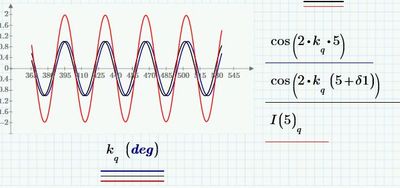

In the attached worksheet, the FFT of a function is calculated. I would like to get the amplitude at each of the frequencies from the signal. From the plots of the FFT magnitude at various frequencies, it can be seen that the peaks amplitude decrease with increasing the frequency. The plots also show that sometimes the first peak is larger than the second peak and sometimes it is reversed.
I was wondering if this is a natural behavior of FFT or I must modify the script. I greatly appreciate your advice.

There are a number of different things going on here, and too many complications in the worksheet to let the basic issues show clearly. I didn't change most of the sheet, but I did remove the second delta 1 frequency term, since it just clouds the issue.
1. The cases of z= 5 and z=500 show the same symptom: leakage. Due to the spacing of the sampling intervals, integer z does not correspond to integer # of cycles over the full sampling period.I added some functions in rev2 (attached) to calc power and actual bin number. z=5 is centered at bin 4.69, z=500 is centered at bin 469.19. the different fractional spacing explains the difference in spectral component amplitudes - leakage is spread differently.

What is happening is called spectral "leakage." This occurs when the total sampling period (based on N sampling segments, not N-1) does not contain an integer number of cycles of the input sinusoidal component. For example, if the input x(k) has 5 periods (freq = 5) over the full sampling interval, then the DFT sample X(5) will have the expected value, and the remaining components will be zero. If the input freq is 5.5, then the DFT in the two adjacent integer bins, X(5) and X(6) will be equal, and approximately 0.64 of the expected value. A number of other adjacent coefficients will also be nonzero.
In the attached rev of your file, I added a plot that shows both spectral components offset and expanded, so the nearby components are more visible. Both show leakage, and the power is spread over multiple DFT components, so that none of these gives the true amplitude of of the input sinusoid. When the actual input frequency falls directly on a DFT bin, then one gets a single true component. You can try some of the other suggested values to see the effects of leakage and when it is not present.
The other file shows the leakage components come from sampling a sinc-like function at integer values. for the case where the input freq is an integer, the zero, the only nonzero value is at the input frequency. If the input freq is not an integer, then all samples are nonzero, falling off only as 1/n away from the center frequency.

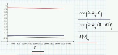

There is a point still not clear to me. When z0=0, the first spike amplitude is near 1 but for any nonzero value of z0 this amplitude's value drops significantly (almost by half). Could you please give me a hint to understand the reason. From my understanding, the frequency leakage could not make such a strong impact, I guess.

When z0 = 0, the equation defaults to I(0) := 1 + cos(2 k d1), which, over the small area you're sampling is a very slowly varying function.  Plotting the two components and the function:
When you take the FFT, we get:
So you can see that for the slowly varying (nearly constant function, the zeroth coefficient of the FFT (which is the steady state or average value) is most of the value.  As z0 grows the functions vary more rapidly and the leakage is more pronounced:  I(5) below!

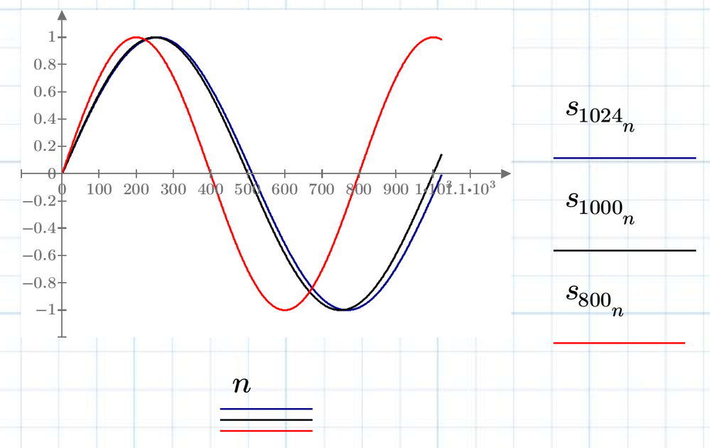

ttokoro
(To:payman)
image.pngimage.pngimage.pngimage.pngimage.pngimage.pngimage.pngimage.pngimage.pngimage.pngimage.pngimage.png

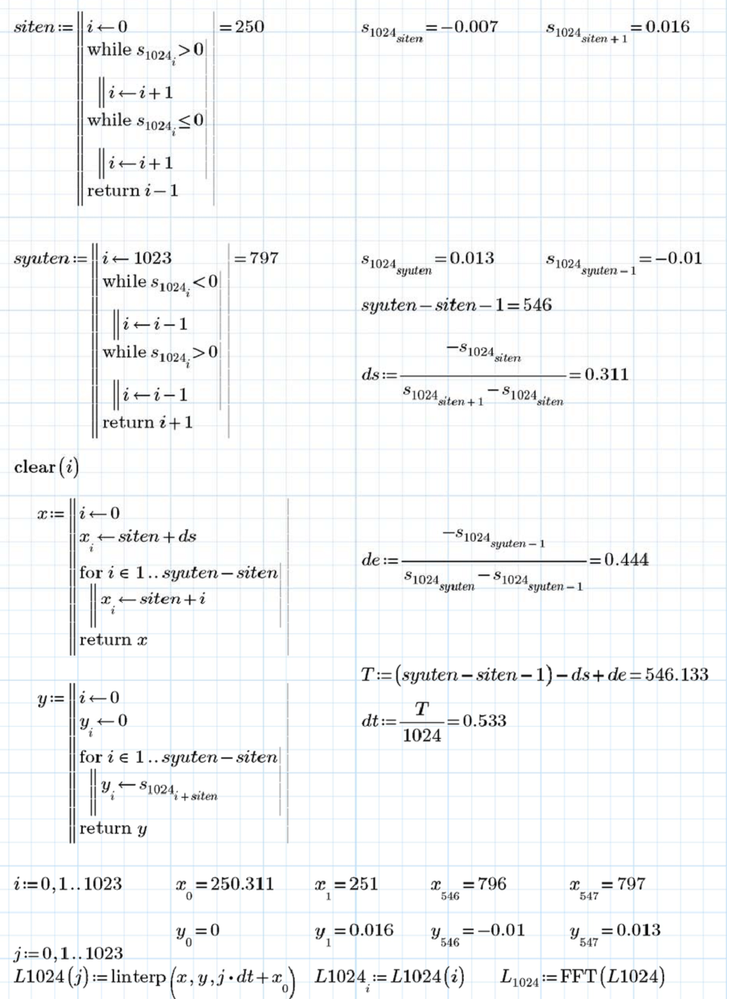

linterp can make true values of signal spectrum magnitude without edge spectrum.

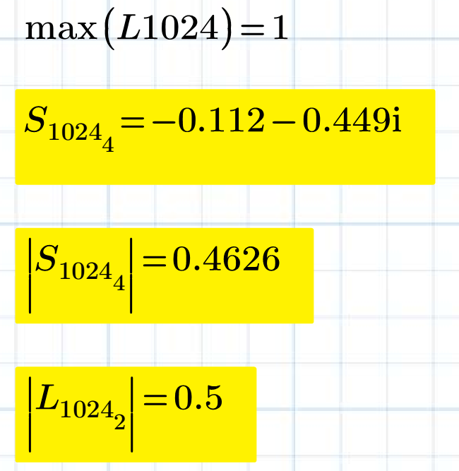

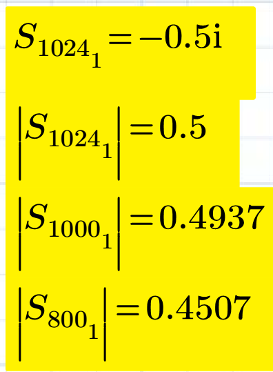

ttokoro
(To:payman)
x,y is original signal data of 2 cycles from 250 to 797 as shown by blue line.
j*dt+x0 is the jth linear interpolation data time of 1024 linterp data as shown by green line.
dt is the new sampling rate of green line data. In this case, new interpolated data have two cycles.
Therefore, the fundamental spectrum of this signal is L1024[2. It is 0.5, the half of signal magnitude.
