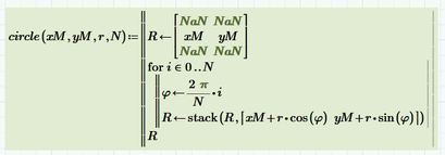

But a better approach IMHO is to use different representations for calculations and for plotting. The parameter representation Alan suggested is best suited for plotting. I prefer a small program which returns a matrix of x and y-values of the points of any circle which can be used easily to plot different circles:
You may use this in the following way. I also plotted the two lines which as it looks are nearly tangents of the circle:
Worksheet in format P5 attached

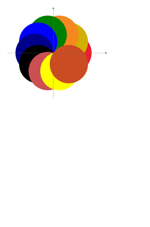

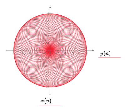

n=100
Using posted techniques.

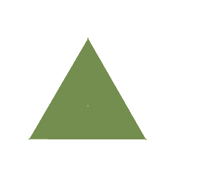

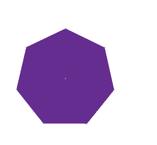

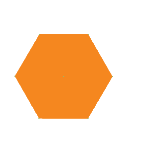

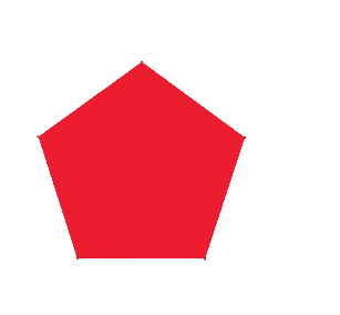

Plotting of polygons by line is easy for Prime 7. However, plotting of closed polygons by color for Prime 7 needs tips.
