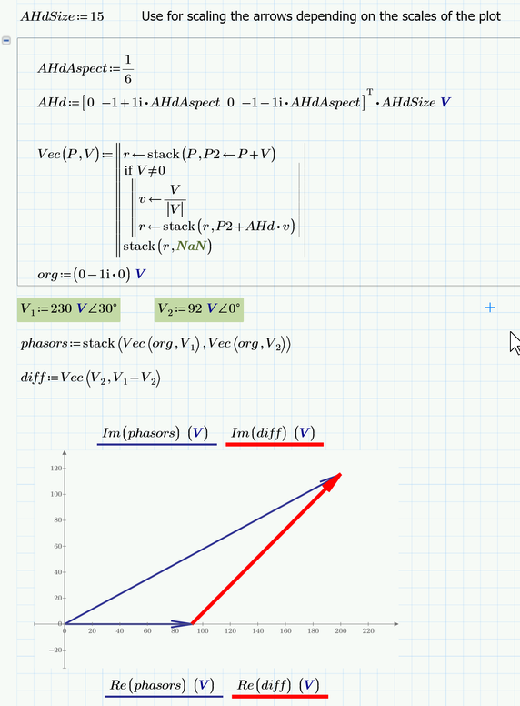

Hello all, I just need to find way how to plot phasors (= vectors in electrical engineering) in polar coordinates in Prime6.
I want to plot individual vectors, voltages, currents, impedances, powers and sums and products of corresponding vectors, starting from origo and starting from endpoint of preceding vector.
I hope to get answer from someone.
rgd matti

Let´s have an example:
Voltage V1:= 230V in angle 30 degrees.
Voltage V2:= 92V in angle 0 degrees.
I simply want to calculate and PLOT
phasors V1 and V2 in POLAR COORINATES
and
phasor V3:= V1 - V2, starting from tip of arrow V2 ending to end of phasor V1, in POLAR COORDINATES
It would  be nice to hear if You really can help me with example plot in PTC Mathcad Prime 6 file.
regards Matti Paaso
So you are not looking for a polar plot, you just want to draw a few arrows given by magnitude and phase.
As you already learned in this thread, Prime does not offer away to easily draw vectors, so we have to write our own routines.
Richard already provided a way to do it in his answers to the original question - whats wrong with it in your opinion? Maybe you are not aware that you can define complex numbers using the versor notation (menu ribbon "Calculate", "Operators").
All thats left to do now is to scale the arrows according to the dimensions of your plot (AHdSize) and take care that both axis are scales approximately the same to avoid distortions of the arrows.
Here is your example and I just used Richards solution as given by him above. The difference vector was made a separate plot to be able to color it differently.

LOT OF THANKS Werner, it took me just 2 hours to add  vector plots to my teaching material as You can see (if You want to take a look). I still want to add polar plotting on the background of phasor diagram TO GET x- and y-scales just same so that phase shift angles etc. can be seen correctly, .... and of course I want to add angle measurement tools for indicating phase shift between supply voltage and supply current etc.
Regards Matti
Sure, you won't have the scaling problem when using a polar plot, but then the illustration might get too tiny as you are forced to use the full circle. Prime's suitability for illustrations is unfortunately very limited.
You can use the very same approach as shown above with a polar plot, too. Instead of "Re" and "Im" you use the magnitude (absolute value, |..|) and the phase ("arg" function) at the appropriate place holders. Furthermore you have to vectorize the function calls, otherwise "|voltages|" would return a single scalar value - the magnitude of the vector voltages, instead of a vector of multiple magnitudes.
We also have to redefine  Prime's  "arg" function to not throw an error if the argument is zero. Prime is mathematically correct in this respect as the phase of 0+0j IS undefined, but for our purpose its better to set the phase to 0 in that case.
Prime 6 worksheet attached.
