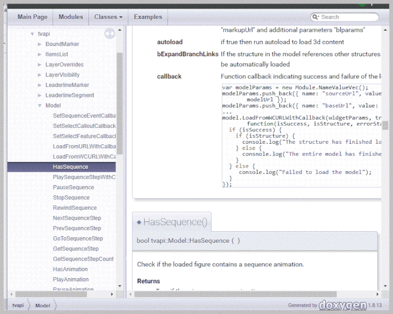

Creo View API Toolkit consist of many parts : Java Toolkit , Web Toolkit (only Internet Explorer related) Office Toolkit and  the new introduced in the current release module WebGL Toolkit.
We can extract BOM list  with Java Toolkit but it requires more complex programming environment. Therefore I think it is more easily to use Creo View WebGL toolkit

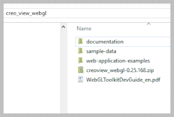

The Toolkit WebGl is based on the Thingview.js library. When we install Creo View Toolkit we will find the following directory structure:
In the web-application-examples  directory we can find some sample files which could be a good introduction how to use this API. The documentation is the WebGLToolkitDevGuide_en.pdf and also in html(doxygen) in the documentation sub directory:

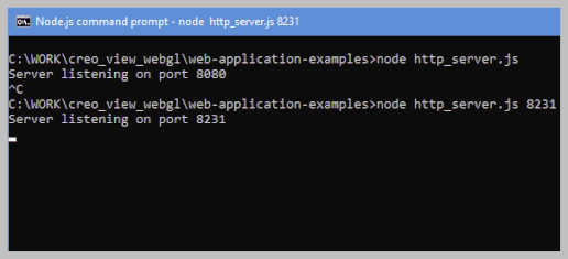

The CreoWebGL Toolkit requires a node.js environment. So  start it we have first to start the Toolkit server: >>>node http_server.js [port]
The port parameter is optional and if we do not use it then it takes by default 8080 :

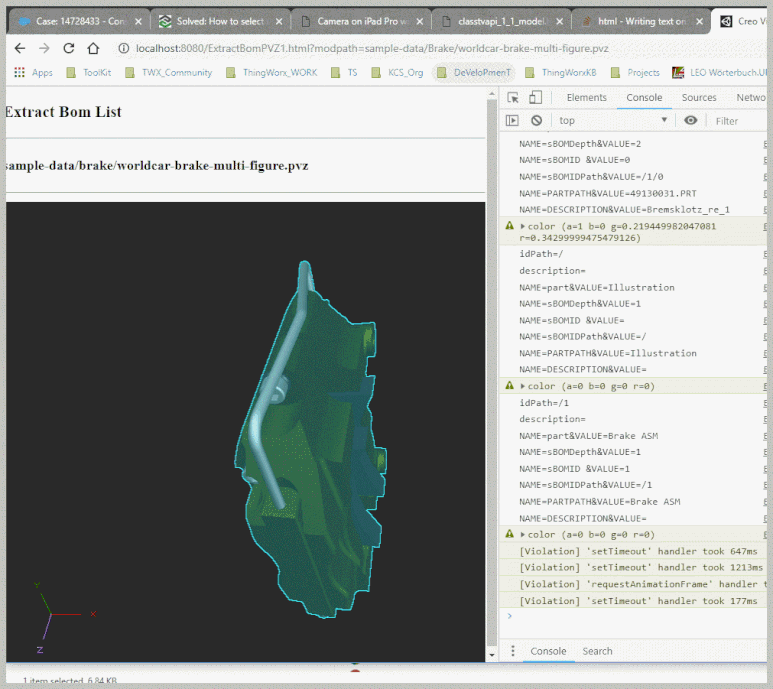

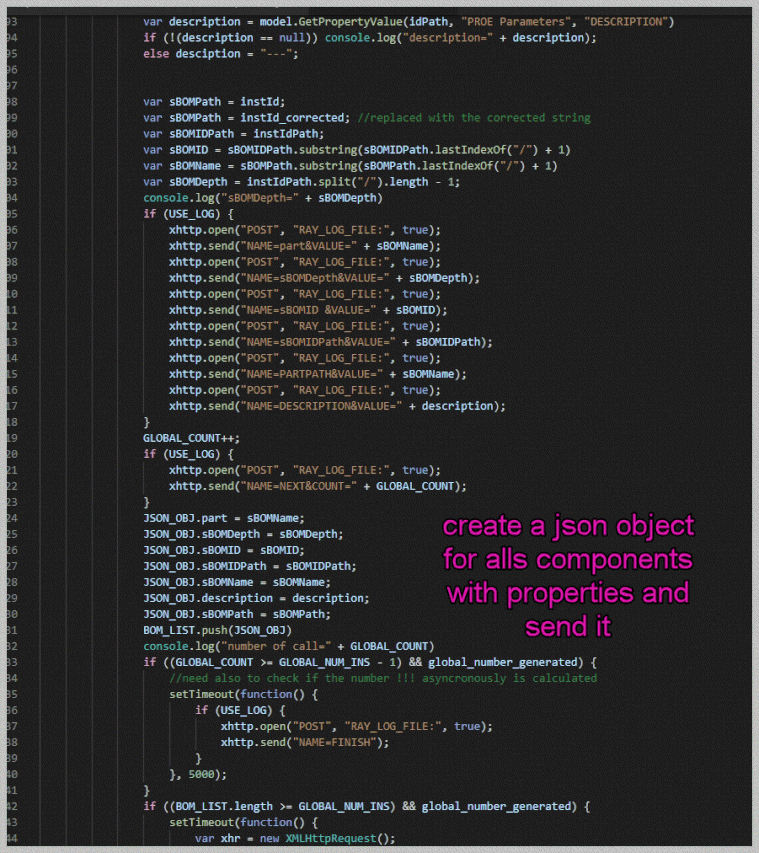

The next step is to open the localhost:port/ ExtractBomPVZ.html which implement our program
For example an simple version which will print the components with some properties  to the chrome console  could  looks like:

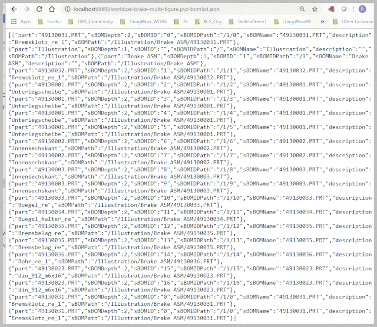

For example here is a  simple version which will print the components with some properties  to the chrome console  It could  looks like:
We can call the Creo View WebGl Toolkit program above in chrome with a parameter which will specify a path of the .pvz model – example:
http://localhost:8080/ExtractBomPVZ.html?modpath=sample-data/Brake/worldcar-brake-multi-figure.pvz
The program will selects all visible components and will print to the console the idPah, partname , color etc…
One problem we have here is that we could not print it to a local file because of the security restriction of the browser. A possible solution is to sent them back to the server e.g. as Json object and save them to the server root directory. Later we can download these file if required e.g. calling the json:
http://localhost:8080/worldcar-brake-multi-figure.pvz-bomlist.json

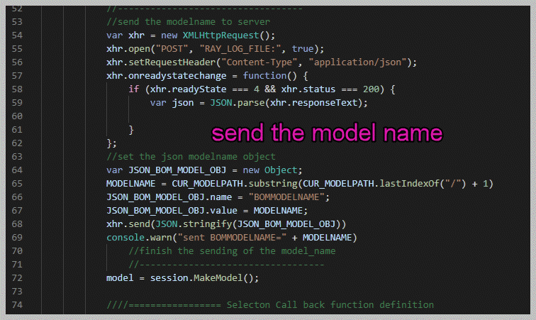

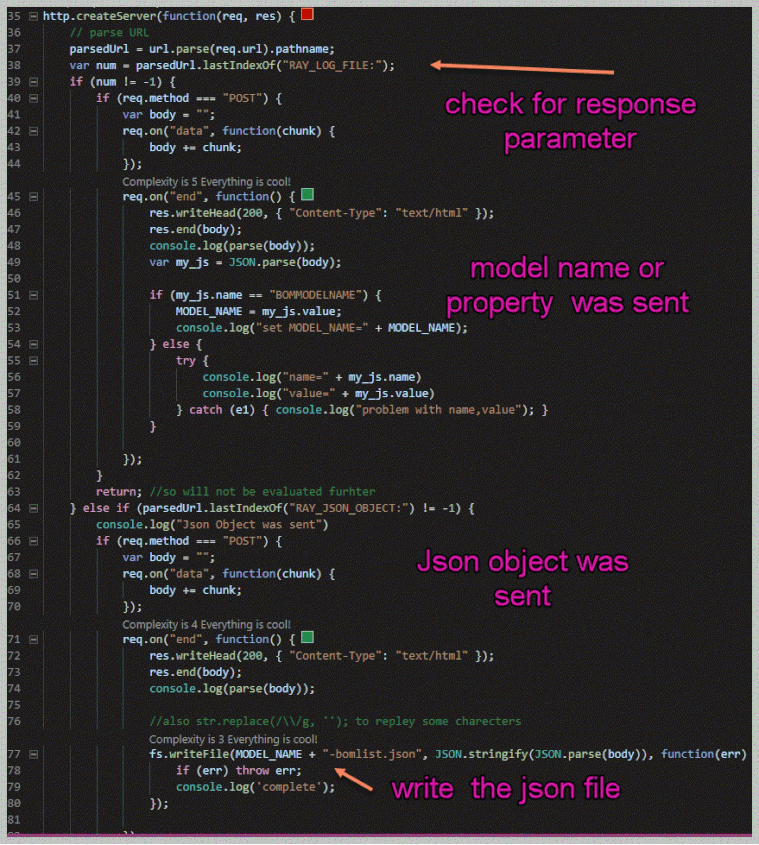

To implement json file creation we need  to change the CreoWeb.Toolkit html file to send data to the server but also we need to modify/extend the server http.createServer() callback function to handle also the received data.
Also as next we will extend  the Creo View Toolkit  program file by adding a XMLHttpRequest() will will send the modelname and the generated json object to the http server

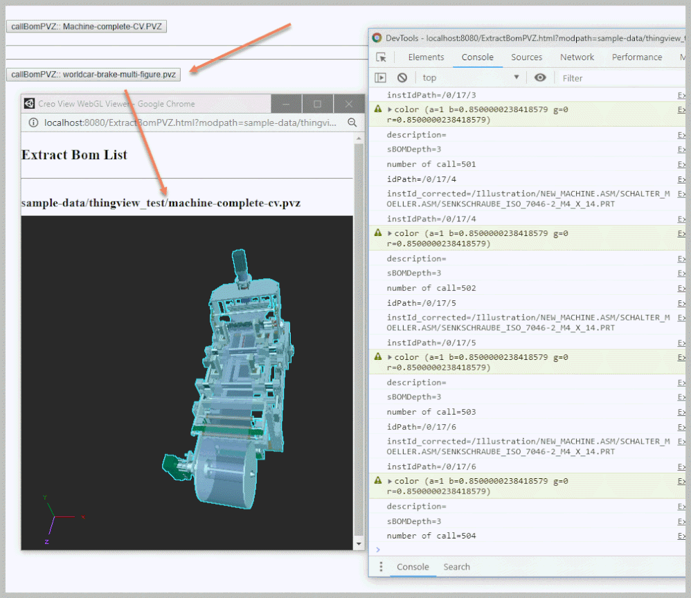

 The Toolkit html file with parameter we can also call from a javascript or other html file:

Hi @harshdeep_1991 ,
yes, it is correct -there is no CreoWebToolkit.html - what here I intended to say  is the server file which we need to start with node.js - which serves the request from the browser. By default the name is http_server.js  and we can rename it to any name. The default call of the server is to start the Toolkit server: >>>node http_server.js [port]
And then we can connect with the browser to the server and could perform some operations with the Web.GL Toolkit API . Actually we do not need to change the http_server.js to be able to use the Web.Gl API , because the Web.GL Toolkit API is working on the client side in the chrome browser. But we have there one significant problem. We are not able to save a data. Let say we want to check the structure of the PVZ file and then create a json file containing the BOM information of an assembly. We will not be able to save this file from browser. So , we need to send it back to the server. And to be able to achieve this goal we need to send json back to server and this is a feature which is not by default implemented in the http_server.js file. Therefore, I wanted to demonstrate here some customization of this file to achieve the sending back of this info to the server. May be,  it is not perfect and there is possibly better more efficient way to do .
I wrote different version/ articles - where I modified the same scripts /html file and created different version. I think here the variable GLOBAL_NUM_INS is something I forgotten to remove.  The check of this variable does not make here sense in the example ExtractBomPVZ.html -> your right.
It is coming form another version named CreateBoomPVZ.html where I tried to select all instances and then used this variable to track the number of the selected instances something like this:

currently the concept of the WebGl Toolkit is the client server.
We have on the one side the http server which is started by node.js >>>node http_server.js [port].. and  on the other side the javaScript program  in browser - chrome which will call the API inside a Thingview component (here as part of the Web.GL Toolkit – but  it is also a part of Vuforia Studio preview) Therefore, probably calling the toolkit form Studio  could work in in Preview mode - means that we can call form preview mode some toolkit functions - but I do not believe that we will be able to perform such operation on mobile device)
The concept currently is the following.
We have a tool where we will  extract some data from the pvz file an pack it to a json file.  The json file will be saved on the server. We will download this file from the server to e.g. to upload folder of Studio project and then we will use it as metadata in the project - e.g. to have information occurrence of modelitems or component without modelitems (the component ID path) and association to part name or some part parameter (coming form Creo)
If we can involve this tool on demand when it is required in an experience is some point I did not considered and is very good question!
Currently the tool is called manually
